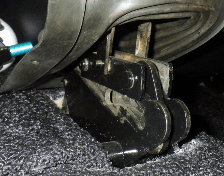

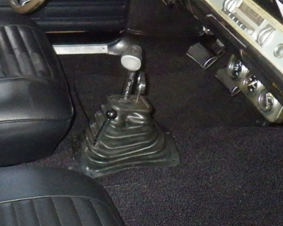

I am looking for correct information and history on the old original inline shifters both Hurst and Mr Gasket. In my searches I have found that most people seem to lump them all together or at least get the actual names mixed up between Ramrod, V-Gate and Vertigate. I've had two Hurst inline shifter, one with a round reverse lever and one with a flat reverse lever. Both had the large L shaped mounting bracket. The easiest to identify is the Mr Gasket version (V-gate, Vertigate???). The Hurst inline shifters appears to have an external lever stop bracket. Is there a difference between the A833 mounting brackets? Also, in that time period, when was the Hurst Super Shifter introduced? Any help would be appreciated.

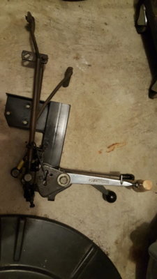

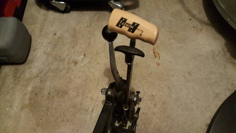

Like this bad boy ram rod ! After riding in a buddies car with one I just had to have one of my own. Searched and found one with a B- body bracket and rods. Then sold the car, now it's garage art and a conversation piece ! Got an old school ivory T handle on it too, apparently they stopped making those in '69 ? At least that's what I remember reading. ... I think

I remember those shifters. They are COMPLETELY BAD-***! It was many years ago....but I think a buddy of mine had one of those. You cannot "downshift" with those shifters, correct?
Sure you can. Straight up to 3rd. from 4th. Pull back to neutral then lift the t handle and pull back again to second. Then straight up with the t handle pulled to first. Not something you want to do unless you have to.

I have one like that right now. It also has the flat reverse handle but the first one I had came with a round handle. I'd like to know the difference.

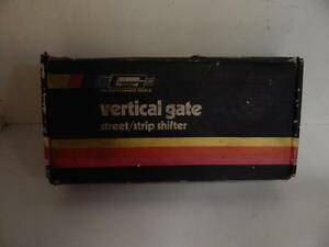

Wasn't the round reverse lever the Mr gasket vertigate one ?
Thanks. The original Mr. Gasket is the easiest to recognize for me. I was wondering what actual name it was marketed under, V-Gate or Vertigate?
I had a Ramrod that looked exactly like your picture. The one I have now is the same except for the reverse lever is flat like the picture in Post #3 by 65-440. I thought that Hurst also had another inline shifter back in the day and it was called a (something-Gate???) not a Ramrod.

MR. Gasket Vertical Gate (also called V Gate) 1st generation was next to come to market, totally different shifter

The A833 used a L shaped welded steel mount for the RAM Rod, Super Shifter and Super Shifter 3.....the A833 used a CAST Aluminum mount for the V Gates-
