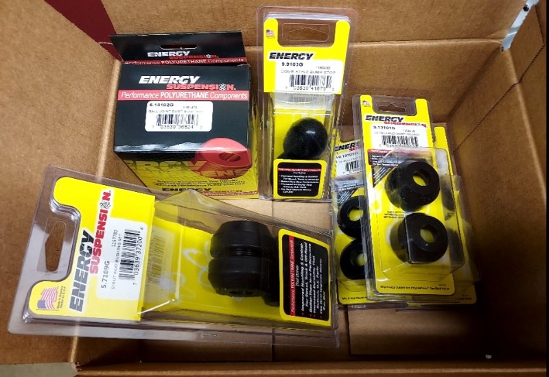

Energy Suspension has them. It's a good product.

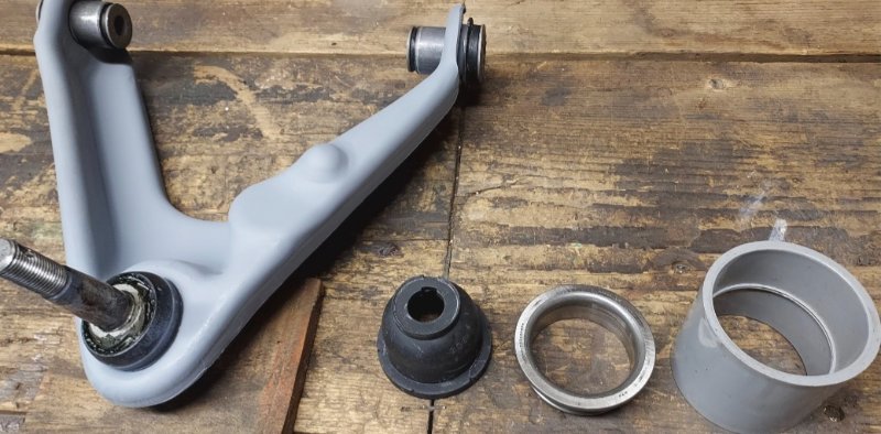

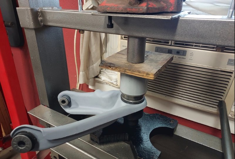

They'll need pressed on. You might get by with a hammer and some kind of sleeve. I used a bearing race, plastic pipe coupler and my press.
Are those the 5.13102G Energy Suspension Ball Joint Dust Boots? I wonder how they'd fit on oem ball joints.
5.13102G
5.13102G
Yes, I believe they are a set, top and bottom. I used them on the Moog K772 replacement.

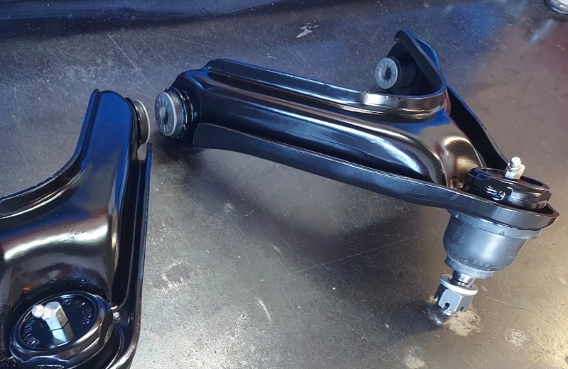

@PARR63 sorry I was thinking top ball joints. The lower that they have just slips on.
Thanks, yes I just need lowers. I'll check them out.
