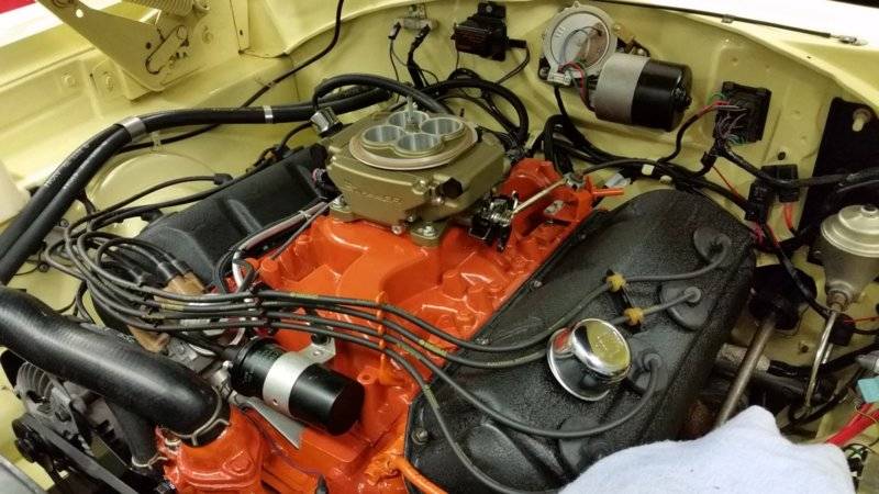

I've got a friend considering doing this to his hemi. Are you running a single 4 barrel or duals? Got any pictures that you can post?
:thumbsup:
Single sniper, and yes I will post pictures for you. I bought the mopar crate 426 hemi intake.

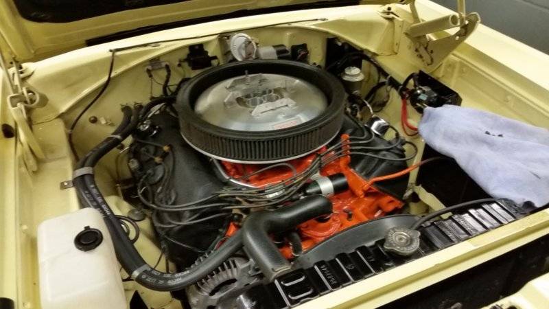

Factory chrome air cleaner lid fits perfect on the custom base.

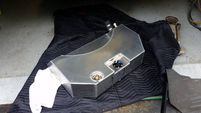

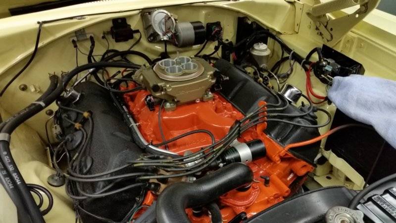

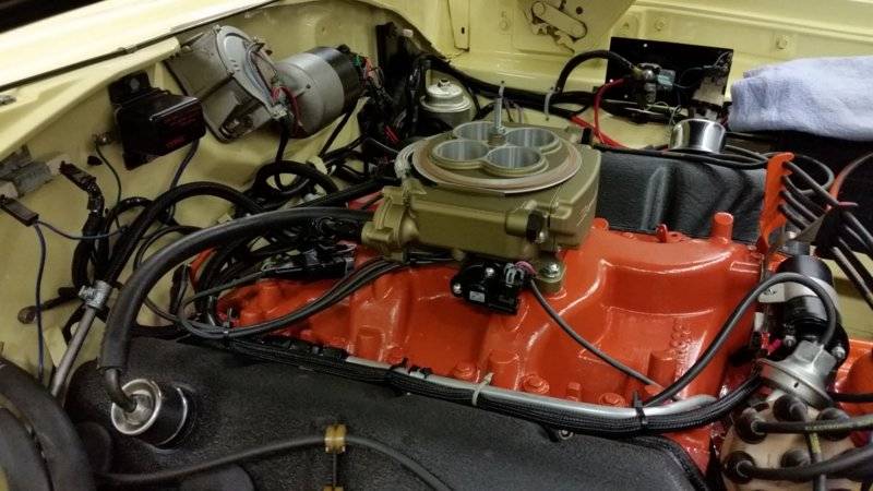

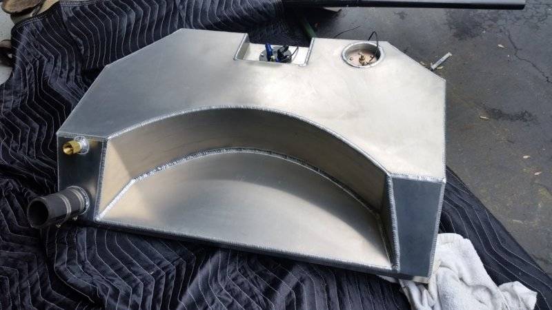

20180512_120207.jpg 20180512_120235.jpg 20180522_171630.jpg 20180522_171610.jpg 20180522_171558.jpg 20180522_171544.jpg
