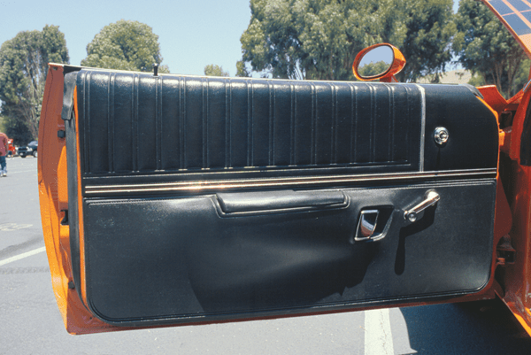

I probably didn't explain it well. The gt8 that the fender tag indicates is the interior trim color, which will be seat/door panel color. The interior colors I listed are the interior paint colors for the dash/steering column etc. Example, for the roadrunner when you have the gt8 soft trim the interior is to be painted in the gt6 dark saddle if that makes sense. There is a gt8 interior paint but it's not available for the b-body, it is a choice for the a-body valiant. I have a link for the FSM download if you'd like it.
The only place the GT8 paint for your fender tag code will be present is on the back of the door frame (facing the interior). It covers the metal part of the frame that's exposed to the interior beyond the soft and plastic door panels. It is the same paint as body color paint used on other 1971 mopars.
In the attached photo, the area to the left between the door panels and the weatherstrip should be painted the "upper door frame paint" color on the fender tag. In the case of the photo, it should be black. In your case, it should be GT8.

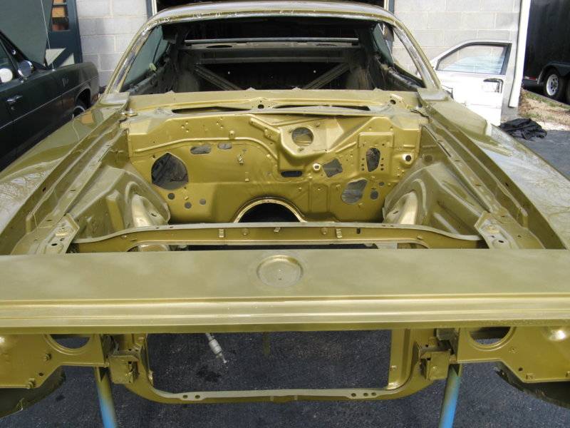

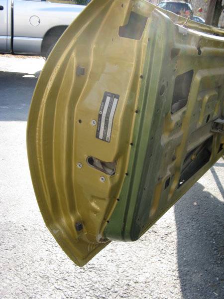

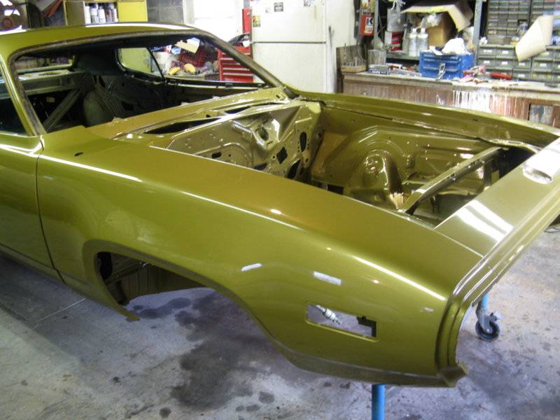

Not many people like GY8 for some reason. I have a 71 in that color and when it's fresh it looks great IMO. Indoor and outdoor lighting changes it a lot....
I like the GY8 , just weird how different that color looks in certain pictures. It almost has a green tint to it in the picture on the right . Maybe my brown interior wont be so bad after all..... :)
Mine actually has green interior. I wanted something different now if I can ever find the time to put it back together...
Couple questions if you don`t mind? Did you spray it base clear? What color primer or sealer did you use ? I was wondering if maybe a white sealer could lighten and brighten the color a bit. What do you think ? Thanks
Whole car was stripped bare metal then vari-primed which is yellow, then gray spray poly blocked out. Then tinted sealer, multiple color coats, then color sanded then cleared. I did not do the paint work and it's what I remember so may have missed something....
