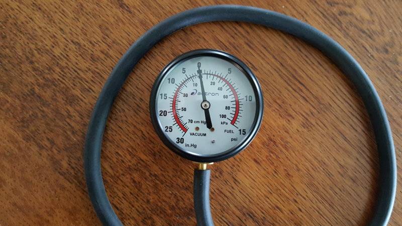

Bought mine at NAPA (Actron brand)

yes, but I can't hold the dash gauge in my hand as I'm messing with the idle mixture screws. Need a solid hand held unit like what khrylserkid posted. OR, perhaps just bastardize a good underdash gauge and make it handheld..............hmmm......... you've made me think............:thumbsup:

Good point. I do run in & out of the car a lot while I'm tuning it. I just like the security of having a bunch of gauges in the car so I know immediately if I have a problem. For under the hood, yes, use one like kryslerkid posted.

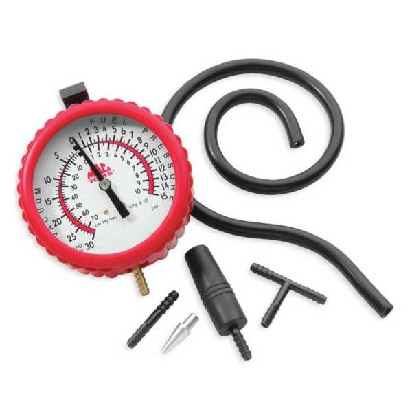

I sold MAC Tools for decades. They have a 3 1/2" vac gauge kit (VG3000)
that is tops. (if you don't mind spending the money.) The NAPA/ Actron shown above is a good one.
