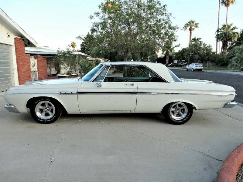

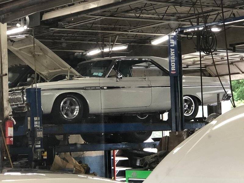

I’m going to be buying new tires for my 64 Fury, there are 215/65/15 on the front and 225/60/15 on the rear. There are BF Goodrich on it now but they are cracked between the tread and are from 2003. I’m not looking for redline or more white lettered tires but I do want a good ride and quiet…..
Ideas??

Cooper cobra has more of block tread and are little more quiet. I think you’ll have to go 235 60’s on the rear though as I don’t think they make 225 60’s. This would also make them both approximately the same overall diameter. Right now your rears are close to a 1/2” shorter than the fronts

If you've got to have those exact sizes again, the BFG is the only game in town - I guess you knew that
already though eh?
If you're willing to go to a 235/60/15 rear, the Coopers come in to play.
Those would be less than a half inch wider and even less than that taller.
