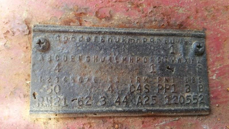

Would someone deocde this fender tag for me. I just want to make sure of wha tthis car is before I take a trip.

The decoder is a little weird to use but Here is what I got from it.. Some may have been misaligned. This is a 68 RR. I had to use the older decoder. HERE

CAR: Plymouth RoadRunner 2 Door Pillar Coupe
ENGINE: 383cid 4-bbl HP V8
TRANSMISSION: 4-Speed Manual Floor Shift
TIRES: F70x14 Red Side Wall, Steel Belted
BUILD DATE: October 25.
AXLE: 3.23 Rear Axle Ratio
INTERIOR: D4S Silver/Black 6
PAINT: PP1 Scorch Red
OTHER: Black Upper Door Frame Color. Black Horizontal Accent Stripe.
MOLDINGS:
25: Drip Rail Mouldings
30: Body Belt Mouldings
ABC OPTIONS:
C4: Unknown Option Couldnt tell if it was C or D But D doesn't come up either.
R1: AM Radio
Z8: Performance Hood Treatment (Roadrunner/GTX)
abc OPTIONS:
u1: Sold Car When Built (Somebody Ordered It)

I am not up on 68 models as much as 69's, but believe C4 is the code for "heavy duty suspension with sway bar".
Where I got the C4 from was the trim code. Pretty sure it was actually D4S I think it was just plugged into the decoder wrong and then came up as unknown. But in the other websites info D4S was coded as silver/black trim. The pre-69 decoder needs some work. It’s hard to get the spaces where needed when punching in the data.

This is awesome. guys. There is not another community out there that comes together like you all.. I guess I need to make a trip as this seems to be a real 4spd car.

The codes I found were on the 68 and older fender tag decoder. The other site I posted above was a site that gave more options. However 69 and up have their own decoder.
Here is one decoder. And would be for 69 and up cars. Plenty of info out there on the web.. As far as what determines what codes are on the tag. They are basic assembly plant tags that tell the builder what options to install. The build sheet does this as well but more in depth.
