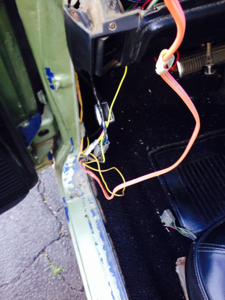

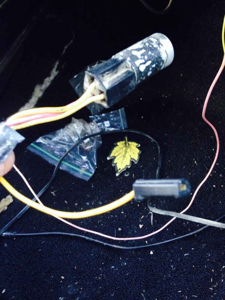

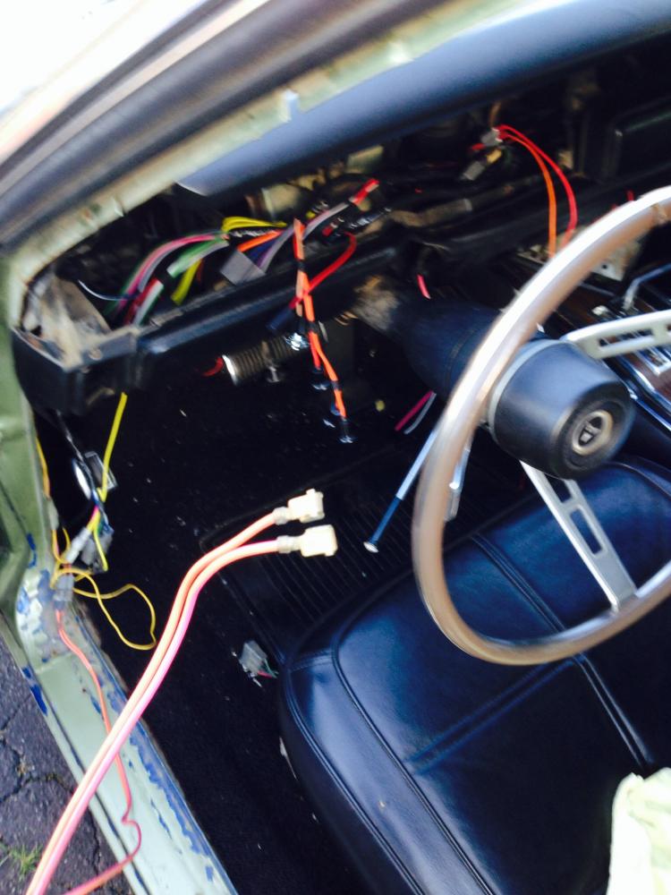

Need help identifying these pics below the two wires that come out by the drivers side kick panel I'm assuming connected to my fuse box I don't have a good diagram showing what they are my guess is they have something to do with the rear lights. The other pic of the yellow and pink wire and a single yellow wire by the glove box
is coming down from the dash it's self not sure if has to do with the map light or AC/heater control this is my best guess not sure where to connect the single yellow wire
I should probably tell you what kind of car in 1969 Dodge charger 440

I believe the pink and yellow, though it looks orange on my monitor (last pic), is for the dome light.
Orange is usually lighting, yellow looks to go to turn/brake lighting.

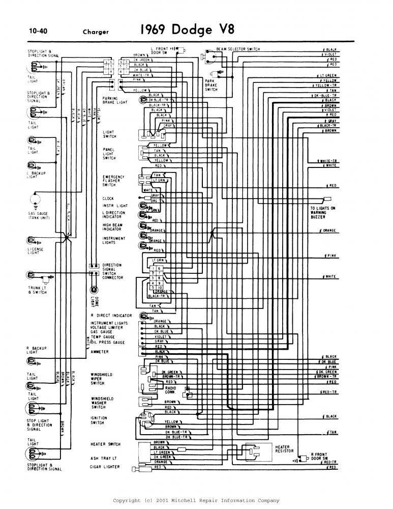

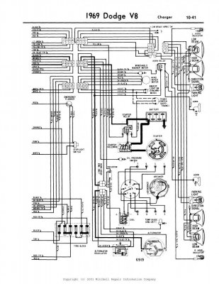

Do these help any?
You can get lots of Mopar electrical diagrams by googling ''1968 dodge charger schematic' and going to the mymopars website.....here ya go.
http://www.mymopar.com/index.php?pid=27
I am gonna guess that the pinks are going to/from the dome light and the others going to the door switches and the trunk light and switch. Just guessin'....

fist pic seems to be the ign switch courtesy light wire, controled by the same flasher/relay ( time delay flasher actually called ) on pic
next pics... did you get connected the console courtesy lights and shifter dial indicator? maybe those are the ones which should be running underneath the carpet ?
Would need an extra yellow wire from door ground ( and dome light switch )circuit too.
The shifter lights and the courtesy lights worked before I dismantled the dash harness I never disconneted those
Thanks for the help so far figured out the first pic still having problems with the second and third I believe it is the dome light I trace the wires all the way down at the carpet it's a wiring harness that has three wives yellow pink and orange when it comes up to the side kick panel it splits yellow goes into the doorjamb into K'NEX to the dashboard wiring harness the pink and orange separate there and connect into another wiring extension that's also pink and orange and the endings look like they clip into the fuse box is that correct ????? Because on all my wiring diagrams that I have there is a pink and orange wiring that goes into the fuse box but right now there's already a pink and orange wires in the fuse box and shoots
into my Dash harness
