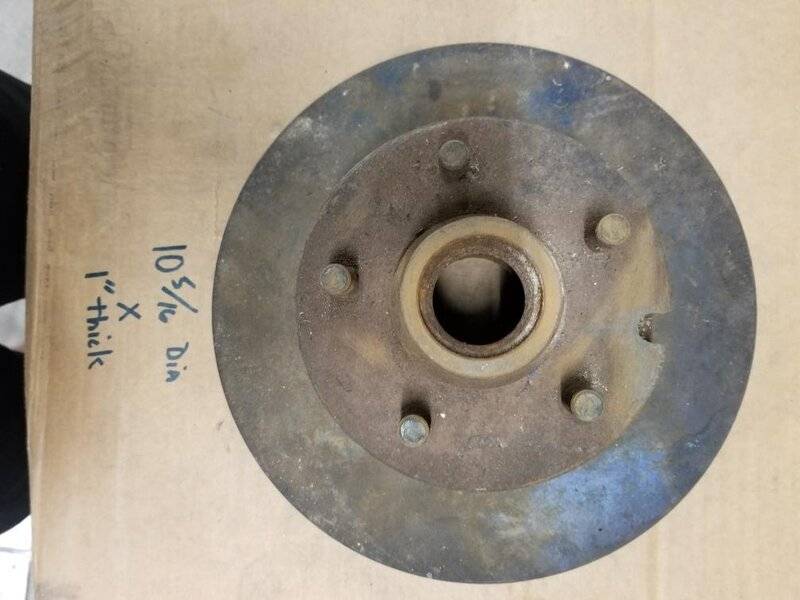

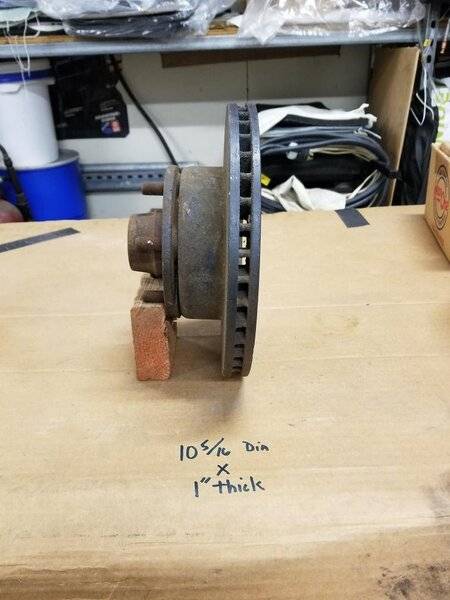

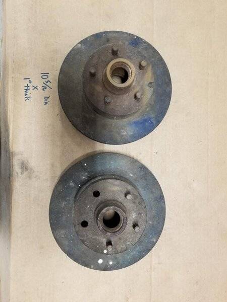

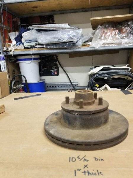

A friend has these. What do they fit?
Thanks in advance!
Do either have lefthand threads? Checked 67 bbody rotors they were 11" or more.
Your sure about that 10 5/16" (10.3)
The Bendix 4 piston stuff is thinner
The Single piston A/B & E body stuff is about 1" thick but is 10.87 is diameter...
Left hand threads eliminate them being Ford....
I don't know of any Mopars with that small of a diameter rotor...
Did u ask the C-body crowd?? Maybe some weird desirable Imperial rotors??!!
They do measure 10 15/16" & both have RH studs.
Looks like a two piece rotor to me.... Did'nt late '60's Goats, chevelles and camaros use those?? Do we know if the pattern is 5x4-1/2 or is it 5x4-3/4??
Looks like those GM cars used an 1" thick minimum rotor too.
1st let me start by saying thanks to you all trying to help me figure out these rotors.
Answers to some questions
Bolt Circle for the wheel studs 5 - 4 1/2"
Casting / Part # number inside L36647-R
The 66 -69 Rotoris thinner and slightly larger in diameter
Any help in solving this would be appreciated. I would like to find a good home for someone that could use these after clean-up.
Will bring to Carlisle if anyone is interested
Mike F
As I said before 70-72 B&E rotors, Actually both RH thread makes them 71-72 but the only change is the studs.... New rotors to replace them but they are a one piece design... Originals like yours are a separate hub & rotor....
Scrub them really good then put them in Evaporust... Make them look NOS.... They fit some very desirable cars & true OE rarely shows up... I've seen them advertised for $1500 for a pair... Don't know if they sold for that but considering how easy it is to spot OE vs the replacement stuff I wouldn't be surprised if they did...
