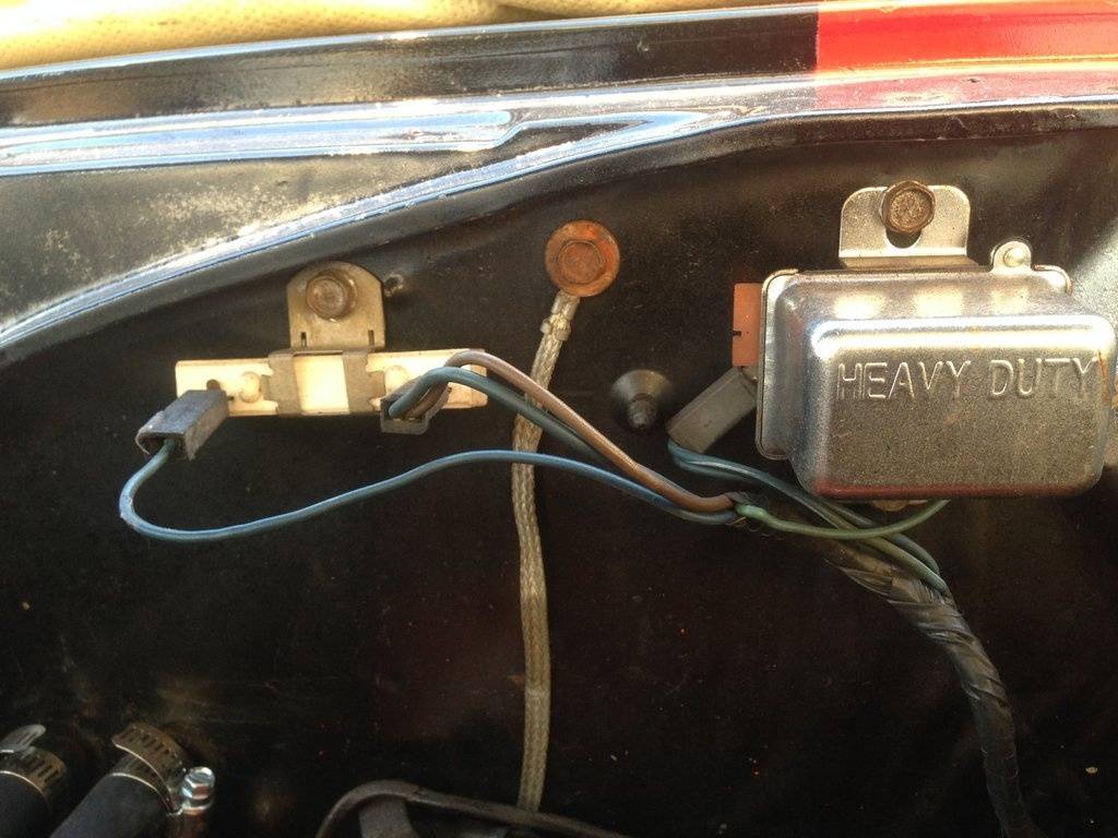

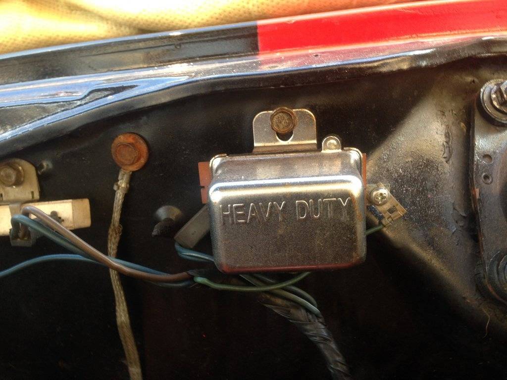

Today I was checking out the wiring on the car in preperation to install the ECU. I have a couple questions and pictures for reference.
I have a schematic and pictures of the firewall. What is the box with Heavy Duty on it called? I get the ballast resistor and how its wired. I just never see the box in and schematics. Googled it and I found out its the voltage rebulator. I should just leave that be correct?
