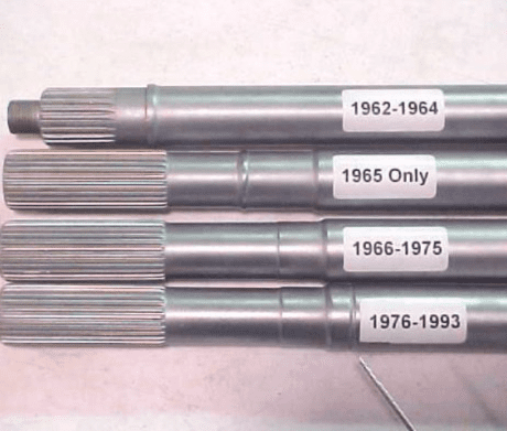

It's along those lines.... BTW the late shaft has a groove to ID it... See the pointer at the bottom..
Well my spare is definitely a 66-75 version. What is the best way to tell what year the motor home transmission is. Are there any date codes on the case? Will the output on the MH trans be long enough to have that ID groove?
