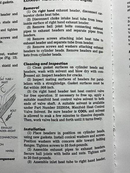

Jerry, I just looked it up in my service manual and it calls for a gasket. Not sure where I read what you said, that there is no gasket. I will look into the gaskets recommended by R413, he obviously has a running, driving hemi with ghaskets. Thanks again.

Morning R413, read my replies to Jerry Hall. I thought I had read the same thing that no gaskets were required BUT in my service manual it calls for a gasket and a torque of 35#. I torqued mine to 30#. The Remflex gasket calls for 20# torque. I will look for the Fel-Pro and see how they fit on installation before I put the engine back into the car. Do you happen to have the gasket number that you used? Thanks for your input.

@Dean Prevolos I have had several original factory 440 cars that when disassembled had no exhaust manifold gaskets. I put them back the same way without gaskets and had no problems. I also have an original 67 GTX 440 car that the engine has never been out or apart. The best I can tell it has no gaskets either. This will be my first Hemi build with aftermarket/reproduction manifolds and I had them surfaced so they would be true as they didn't come on the engine from the factory. Maybe I should use gaskets being they're not original to the engine, but I owe it to myself to try this as when engines were assembled from the factory the manifolds they used had never been used on an engine before. This is just my opinion and something I am going to try. My thoughts are that the service manual was written for reassembly of engines and parts not necessarily original to the car. I'm as interested as anyone here to know, but it's going to be a while before this engine goes into a car.
