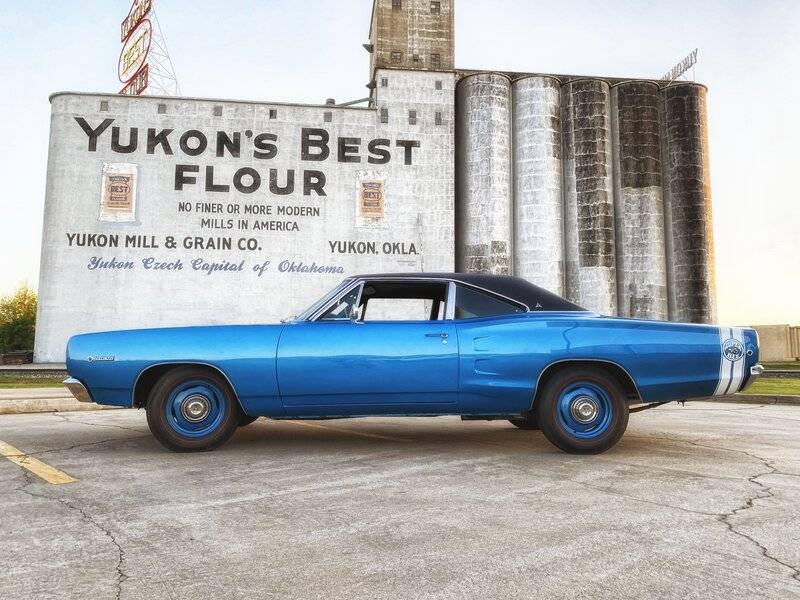

I have a 1968 Super Bee 426 Hemi car. Is was set up as a strip drag car, hot cam with a shift kit in trans, 410 dana with super comp springs.
It came originally with 8 3/4 323 posi, and I am wanting to convert back.
What cam and lifter set do I need? I am looking for a nice rear end, gears, springs. I want original stuff. Robert
