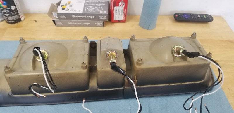

I ended up cutting the sockets in half with an air saw then using a carbide bit to slowly ground off the edging until I could pop them out without damaging the plastic.
It worked out pretty well.

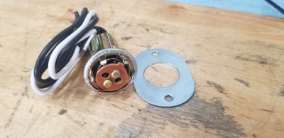

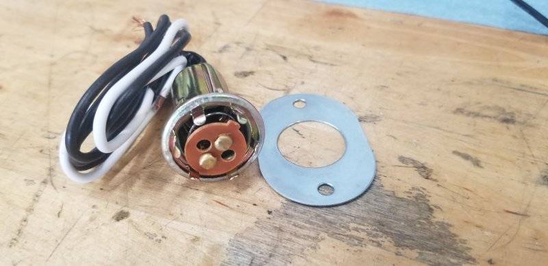

I just put the new sockets in. I used standard motor products part# S91. They fit the existing hole very well. I put a dab of epoxy on the lip of the socket and snapped them in place. I did not use the metal backing plate that comes with the new sockets.
I couldn't find a single filament socket for the backup light that would fit so I used the same double filament socket but I'll only use the bright one.
