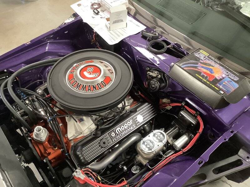

I have the mopar performance big block cast valve covers with a twist on hole and knock out spot on each. I am installing a m/e Wagner Pcv valve in one of the twist on holes. It needs 3/4” id. Does anyone know which grommet with that id also has big enough diameter to seal twist on tang cutouts also. I read a review of Ford grommet M6892F working well on the mopar covers. but Not exactly sure of thickness of groove needed either, covers are an hour away so I can’t measure them right now but want to get parts ordered. The Pcv valve is actually going on rear of passenger side. This is a pic last week when I mocked up this cover. Thank you

Edit- I just saw That you wanted to use the twist lock hole for your PCV... Not a good idea IMO. There are different thicknesses around that hole with two protrusions, made to lock the cap in place so it will be very hard to seal it with a grommet...
You need to punch out one of the other holes, but do it small enough to leave a lip for the grommet to seal to. In other words as you can see in this picture don't punch your hole out the same size as the hole boss that's cast into the cover because it's about 1/2" thick-
The cover is very thin at the top of the hole, like .030 or so...
This is what was in mine, no leaks with the pcv stuffed in it. .
Mopar used to cast left and right side covers but nowadays they're all driver's side. You'll have a longer hose to your PCV as a result and it will stretch across the passenger side. (I've never seen any PCVs that will accommodate the oil filler opening boss on the left side but they may exist.)
