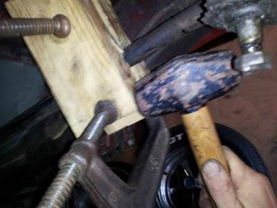

Two blocks of hardwood V'd and bolted together to clamp on, or undo the LCA lower pivot nut enough to give it some slack and give it a wack to drive it and the bar back out of the cross member.

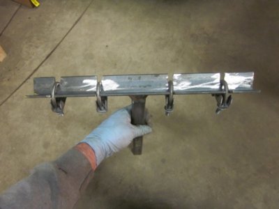

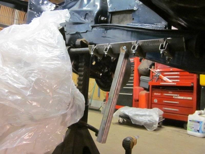

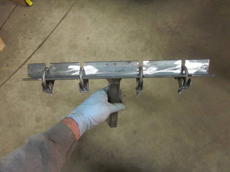

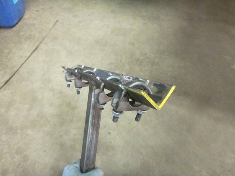

I made one that worked like a charm.

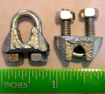

I have always used a larger version of a cable clamp but you will probably need to go to a company that specializes in chains and slings because of the size.
