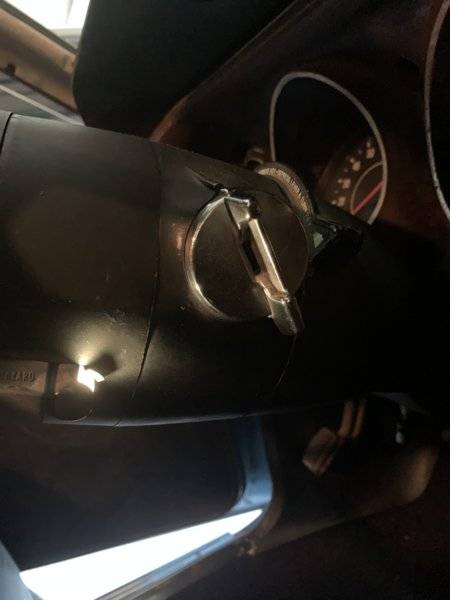

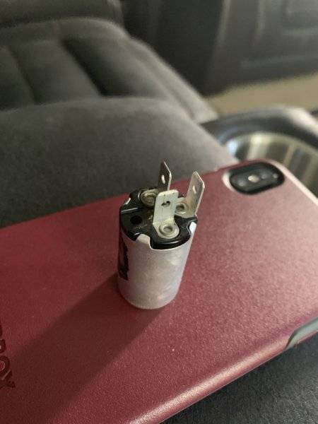

The ignition switch light that is supposed to go off after 20 seconds stays on all the time and subsequently slowly drains the battery. The first picture is of the capacitor that I’m told is causing the light issue and the second pic is the light I’m referring to that stays on. Any help on where to find this capacitor is appreciated

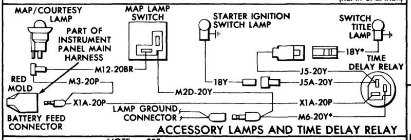

That is not a capacitor, but is the "Time Delay Relay" for the ignition light. Now you know what to ask for at the parts store. Here is the circuit...
Chrysler Part # 2889565
I bought one at my local Dodge dealer in 2016 for around $17.00
Don’t know if they still stock them today
