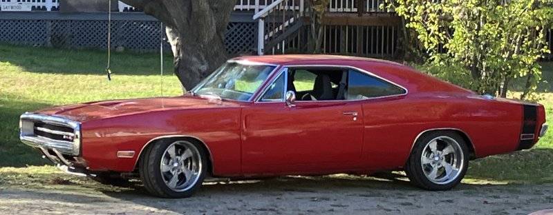

MY Charger aligned to 6 degrees of positive caster and 1/2 degree of negative camber with stock control arms and offset bushings.
It is now set to 1 degree negative camber and 8 degrees of caster with aftermarket UCAs. No, there is no accelerated tire wear except with the rear tires....
