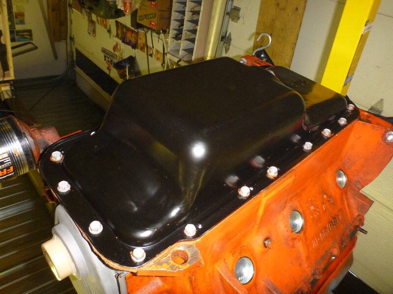

I run that same reproduction 402 Oil Pan on my 383/432
That reproduction pan was on that 383 for a few years before I turned it into a Stroker
Had that pan off a billion times chasing an oil leak that ended up being a bent timing chain cover that wouldn’t seal around the alignment pins and oil leaks flow down and back along the gaskets
Anyways , inside of the pan was absolutely never never an issue when I cleaned it down inside , with that black e coat paint and I would have never even considered removing that paint

I love the pan honestly - I thought it was a pretty damn good quality , good metal , well built pan in direct relation to my factory 1971 bent out of shape oil pan
Thanks for your feedback; you are the first to have actual experience with this pan!!
