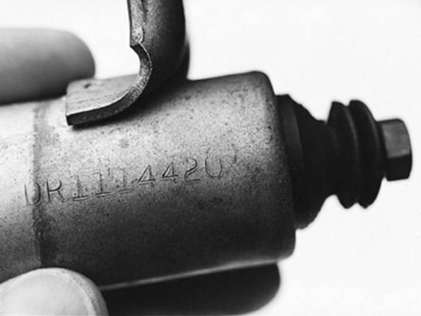

I know it's been almost 2 years since got back to this thread, but I still haven't resolved my solenoid issue. I got distracted and ignored the issue. Now I'm looking at it again. I've learned that I need a model DR1114420, exactly like the one in the photo...NOS, used or a kit to rebuild the one that I have. Any help would be greatly appreciated.

The reproductions have pretty much all been sold off and is no longer in production. No big loss as they never did work any way. NOS ones sometimes pop up and can bring $300 plus. The 70 style is even more difficult to find and more expensive. The solenoid is a Delco Remy piece and was originally used on the late 60s Pontiac 6 cylinder applications. Standard Ignition had one available many years ago and you might be able to stumble across one of those. They did work ok, but they are about like finding an NOS or nice used one.
They can be reconditioned, but I would suggest sending them out. At one time, Scott Smith of HARMS Carbs or Bill Overcash would occasionally take on the job. You would just have to reach out for them to see if either would be interested in the work.

I have mine in place but inactive, don't need it. Mine also shorted out internally and the wire started smoking so I replaced the wire, took the cover off the solenoid and cut the wire internally that was soldered to the male connector put it back together and plugged it in so it looks 100%. Don't have to worry about a possible wiring fire.
