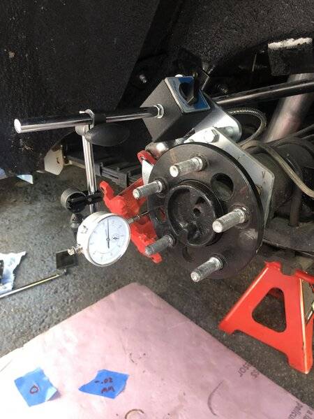

Finally driving and car behind points out wheel wobble. We put it up on stands and it is pretty bad, both sides. Pulled wheel and retested with disk only installed and it is still there.
68’ 8 3/4” with new 489 3.55 sure grip. Axles are original with green bearings. Rear disk conversion(Right Stuff).
I am going to check the housing today, but I in it hard to believe that both ales are bent. History of the car is known and no wrecks. Any thoughts on where to start chasing here?
Keep stripping it down, check the axle flanges with a dial indicator next.

Here is the math. My gauge is in .01mm.
Looks like 3 o’clock to 9:00 is .05mm diff.
12:00 to 6:00 is .04mm out.
can someone give me a ruling on that. I will convert to inches in a minute.
067670AA-62AA-45BF-AB80-706E3AFBE641.jpeg CDBD2A5B-5CAA-499E-AF24-FCDA74D50388.jpeg
In English looks like .00196” and .00157”.
Seems the rotors are not seating on the stud shoulders.
I'd say that's good, without pressure against the flange you may just be measuring end play/bearing slop. Those studs look like they have a LOT of shoulder. Maybe the new rotors just need a lick off of their mounting holes.
May only need to counter sink back of rotor rather than drill?
Rotors. Opened up the holes with a stepped bit. All back in order now; Sort of.
