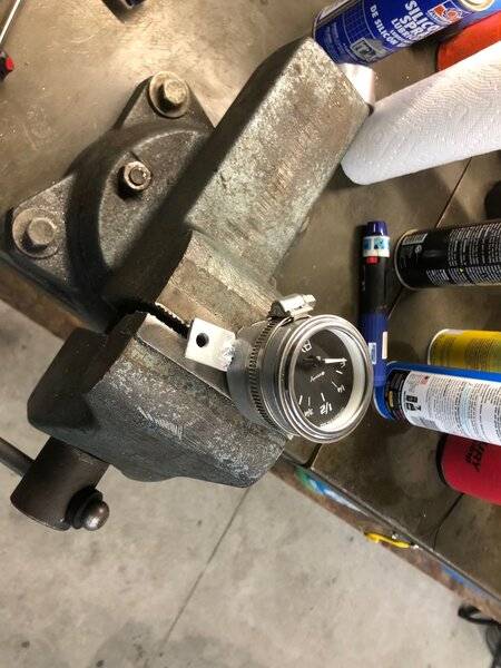

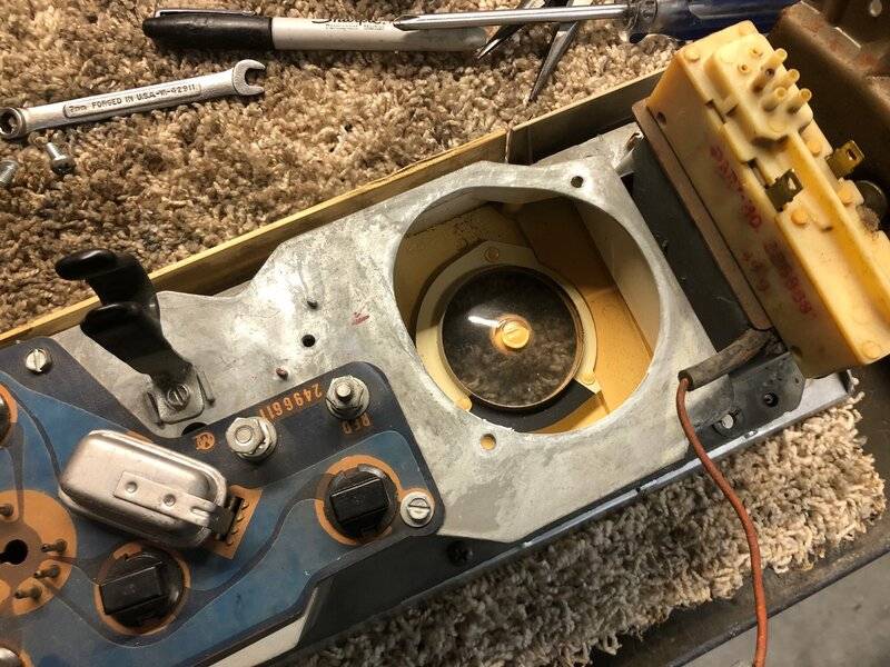

Anyway, I got the looking at a '65 dash, and where the clock would go looked like the perfect place for a new, round gauge.

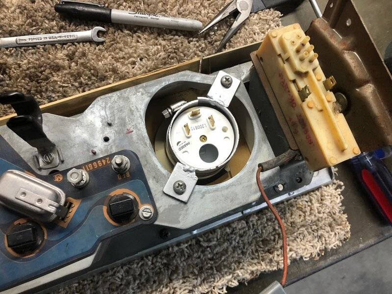

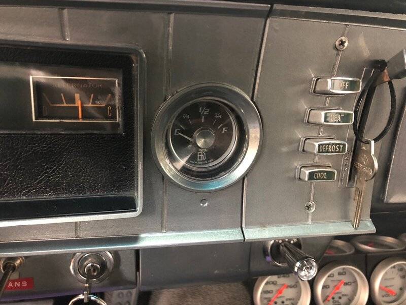

I made a tube out of a 2" ex. pipe, slit it length wise, put a hose clamp to tighten it and welded a couple tabs on to mount it in the factory holes where the blank or the clock mounts and I think came out perfect, one would have to look long and hard to even notice it, AND it works perfect!
