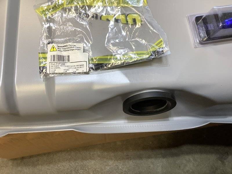

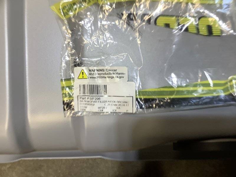

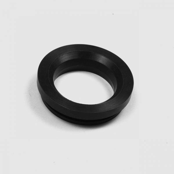

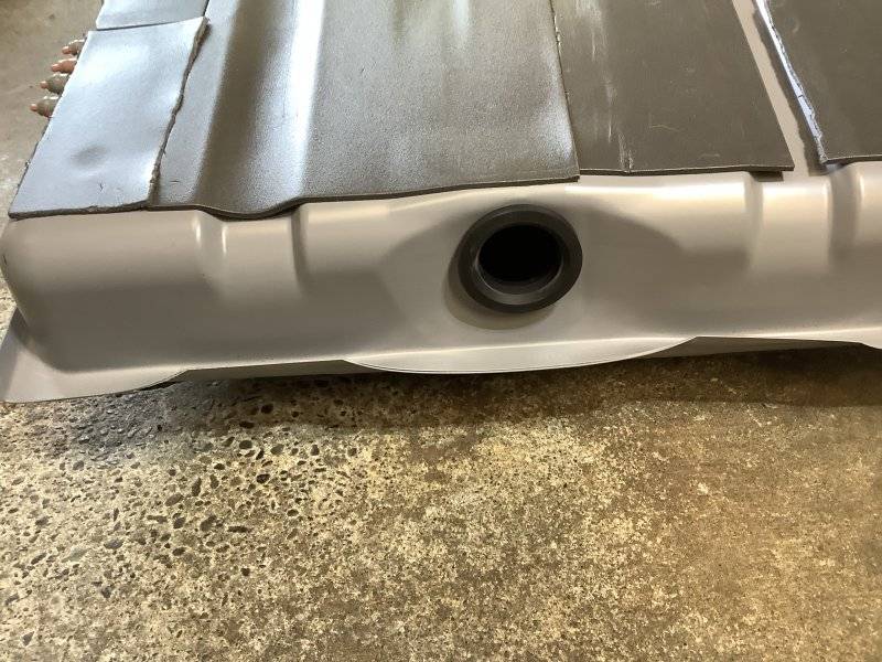

I hope this helps because I just went through the filler grommet issues with my Charger and this one actually works and gives enough to slide the neck in and seems to seal properly. I took pictures so I have a reference if needed and maybe this will work for you. I ordered a different one along with this because I anticipated fitting issues. :luvplace: :moparsmiley: :thumbsup:
