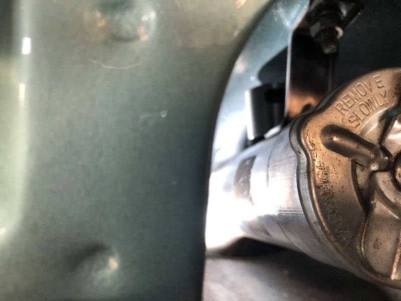

I mounted it just forward of the filler tube mount bracket, sorry not a great picture. The valve installs like a bulk head fitting with the smaller nut part inside the filler tube. I can’t remember exactly but I think I cut off the AN fitting threads to give myself more more and their not used anyway
Dan64 - how did you mount this into the filler neck? I thought all ‘63-‘65 filler necks have that metal ‘baffle’ welded inside of the filler neck - I believe to let air escape while filling the tank. Curious as to how you were able to work a nut into that spot because there is no access to it.

I remember it was a little bit of a PITA but i can't remember exactly how i did it. I'm gonna have to look at it to see if it jogs my memory, but yes, it did have a baffle in there.
Not sure how well it will show up in the picture but I used a rubber o ring on the outside of the fitting. Baffle is still there, can’t remember if I modified it or not
Thanks for the follow up!

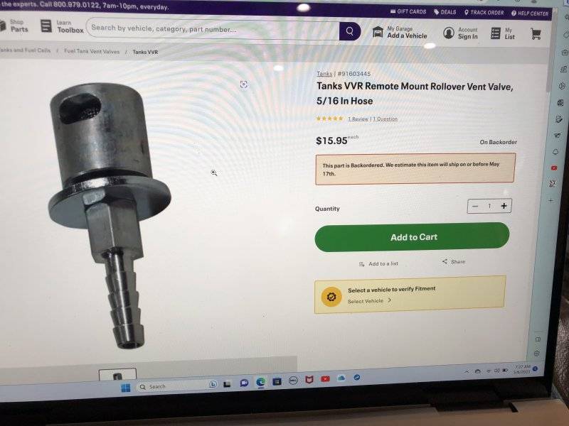

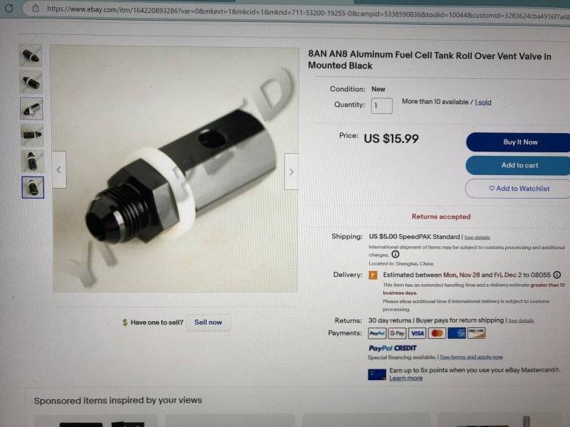

Got another question. As far as I know, these bulkhead mount vents are supposed to be mounted internal to the tank with the AN fitting on the outside. That should mean the valve is venting when in that position and closes when the car flips over.
You’ve positioned the valve upside down so it should be closed in that position, correct? I’m not sure how that vents, especially when gas is leaving the tank - it would be closed and not allow air to enter thru the valve. And for expansion in the tank it, the pressure would need to open the valve. Am I missing something?
Mine is venting in the position that it is installed in, it shuts off when gas rushes up the filler tube and slams it shut temporarily,it has to be installed in this manner or it wouldn't work as intened . If you look at the picture i posted in post 5 it's actualy different version than the one i used on my car ( post 13). I just grabbed a pic off of the internet as a example.
Okay, I had to go back and look all this stuff up. The vent I used was a Tanks inc. REMOTE rollover vent which makes a difference . Check out #2 on the install and pictures. It looks like I cut off the barbed portion not a "AN" portion, it hard trying to remember all this little stuff on a build, sorry if that confused anyone.
Excellent- that makes sense. As I’m just going thru this, it’s all new to me. I really appreciate you going back into your memory banks and sending this out. I think I may give this a try.
