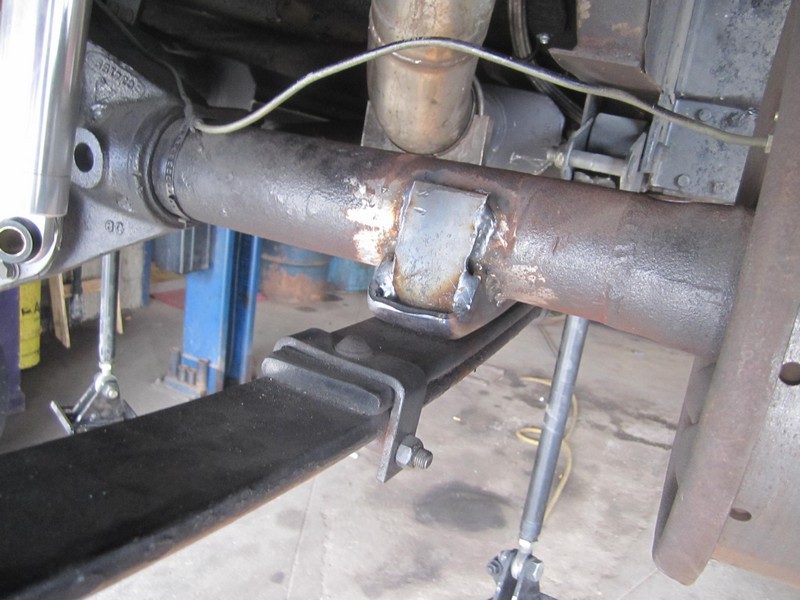

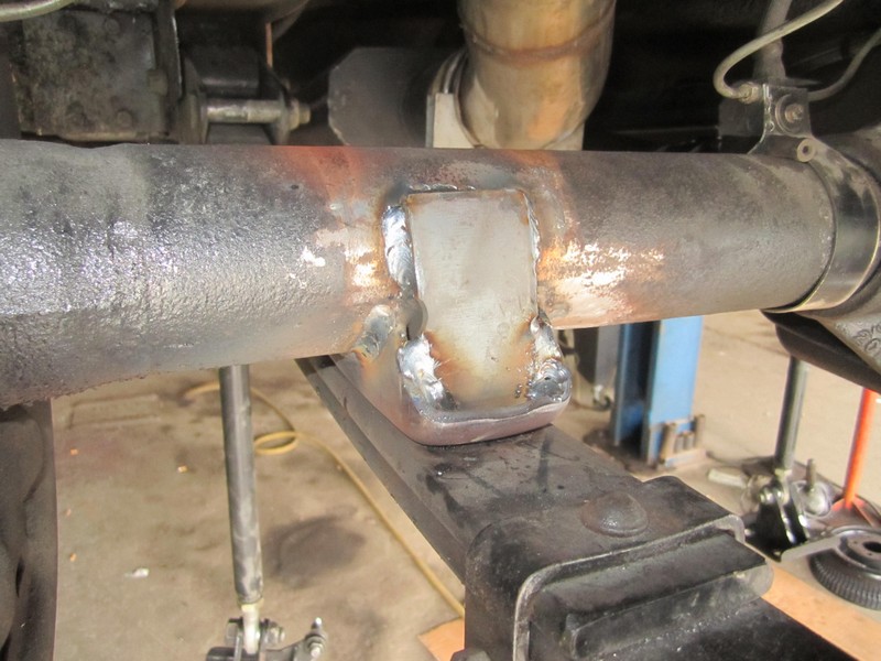

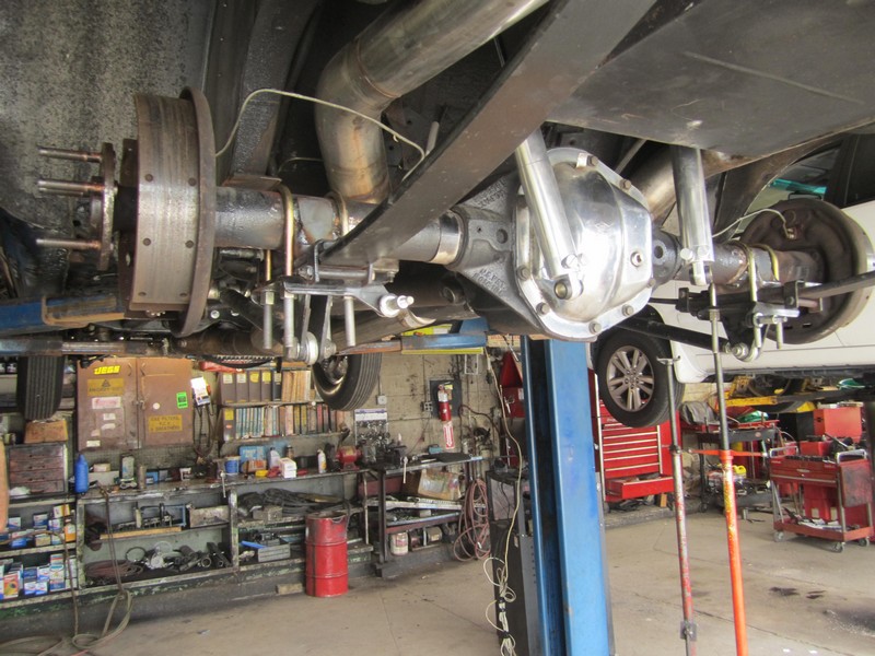

Getting ready to install new perches and was wanting know if I should install them with a few degrees of down pinion angle. Thanks Ron
Not sure about that but weld them on very very slowly so you don't warp the housing.
Did you buy the perches yet?? If not get the Caltrac perches. If you have them already,you need to calculate your pinion angle and tailshaft angle to determine where to weld the perches.
While you have the welder out,brace the back of the perch to the flat part,not the end.:blob1:

Thanks for the heads up on the Caltrac Perches. Ron
