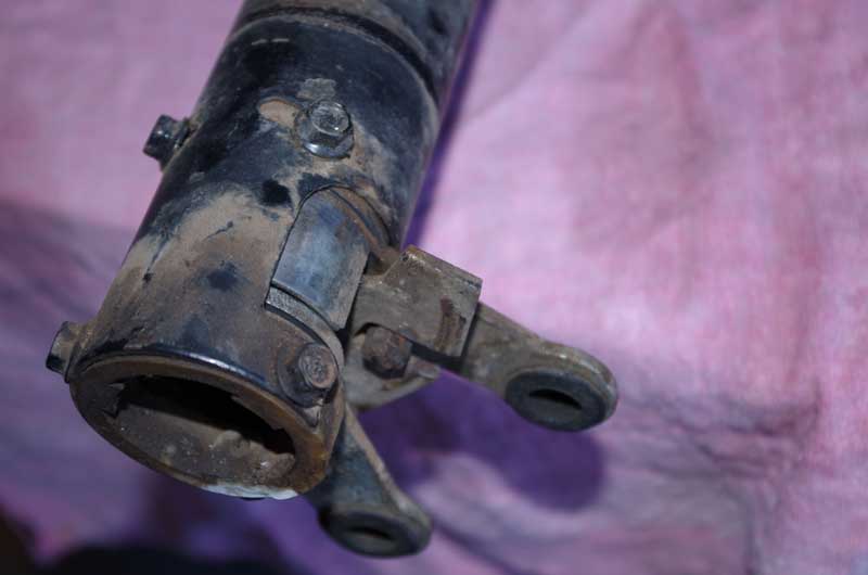

Right now I have a major problem. whenever I had to take the steering column out, I would take it apart, clean it, and regrease it. I have done this about 3 times over the years. At this time it has become so worn that the gear shift levers that the gear shift rods connect to that go to the A230 transmission are so loose that I am having difficulty shifting. There is a diagonal slot for adjustment on the steering column just above the levers, but I am already way at one end of the slot and out of adjustment, hence the slop in the levers. Attached is an image of the adjustment slot and the levers that are too loose. What I am thinking of doing is machining a spacer, about 1/8" thick, out of the same kind of plastic material used in the steering column, or maybe something tougher, like Delren(?). Does anyone know if this will work or would it break apart in a short time?
It seems odd that that the levers should wear to such an extent that they are so loose. I know this is not normal because there is spring washer that indicates to me they should be tighter so the spring washer engages. Maybe I left a spacer out when I put it back together again about 11 years ago although I doubt it, but it is possible. Does anyone have an exploded diagram for this steering column? One thing I need to know is if I put the levers are in the right orientation, if that is possible. This could be possible if the square cutout on the lever does not line up symmetrically with the end that the gear shift rod attaches to. One reason I think they may not be symmetrical is that I am having problems adjusting the linkage according to the manual. If the levers are not symmetrical and I dumbly flipped them 180 degrees from the orientation they should have, this could cause the problem.

Welcome from Alabama, nice B 100, it's certianly clean. I would suggest finding a wrecking yard for replacement parts or column. Being a manual transmission it may be a little harder, but there's sure to still be some out there.
