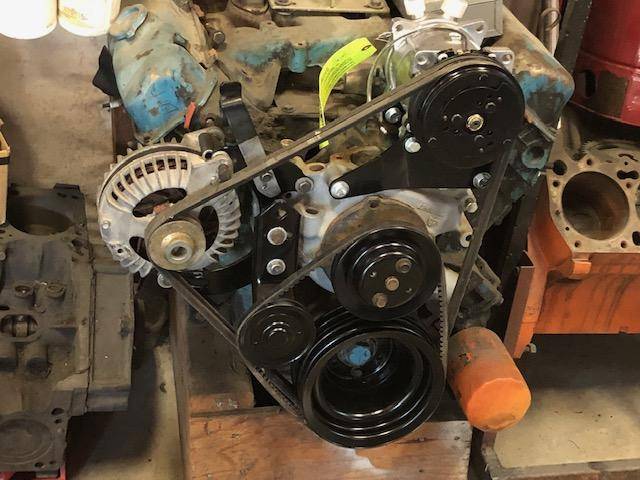

Thanks my most recent issue is squealing belts after an AC install. Alignment seems good. I’m wondering if I’m missing an idler pulley and if so where does it go?
This is how a 1970 setup looks. Not sure about earlier years.

I still get belt squeal sometimes but from the small belt that drives the fan and water pump.
Welcome from the former home state of your new neighbors. The squeak may be from mis matched belts[ should be a matched pair], being loose, poor quality belts, glazed pulleys, accessory mis alignment[ pulleys not in line with each other] and some other possibilities.
I've done everything I can think of changed out the belts brand new matching set. added spacers on both sides to change alignment
Just curios , Saw a car like mine at a show and he is only running one belt on his a/c alternator with 2 groove set up. Any one else doing this with good results, still chasing that belt squeal

Welcome from Canada! Do the belts squeal if the air conditioning is off? Does the compressor pulley turn freel?
