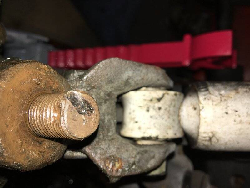

I think it's just the frustration of separating the upper and lower ball joints from the spindle to get all new/NOS parts. The upper ball joint came out with the loudest pop and broke my separator tool after a long fight. The lower ball joint is just stuck in there and it's going to get some heat and cutting soon. When you are staring at everything pulled, if only the sway bar and strut rods are left, you think so why not while I'm at it. :) Thanks again!
Not sure what is going on there but first of you probably shouldn't be using a separator on the ball joints, you just need to "smack" them with a HD hammer on the side. If you look at the BJ there should be a flat side you can hit. Mopars usually don't like the BJ forks. I've taken a lot apart over the years and found that the forks don't usually work all that well.
This is what I am talking about
Yeah I know. I tried a fork and then used hammer, etc. Got frustrated and tried other puller. Never had one this bad.
