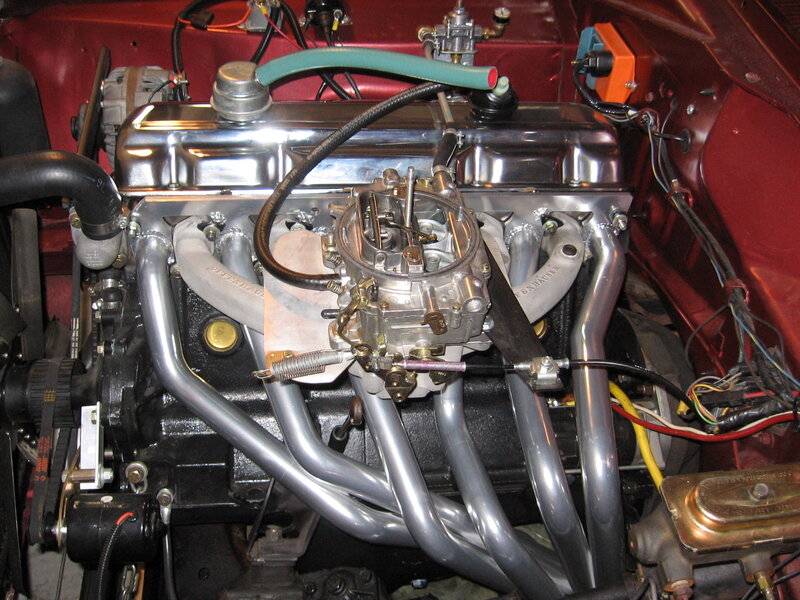

The oil cap/breather to the air filter,the crimp on the aftermarket style will drip oil out the crimp.I just clean and apply silicone around the crimp.Or use the factory one as is pictured, never had one drip.Last is where the PCV valve is,is a GM part,Mid 80's that is baffled.Helped with the old Slant's oil woes.
