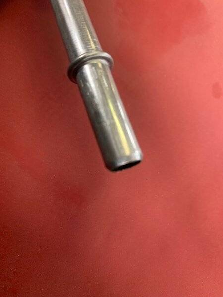

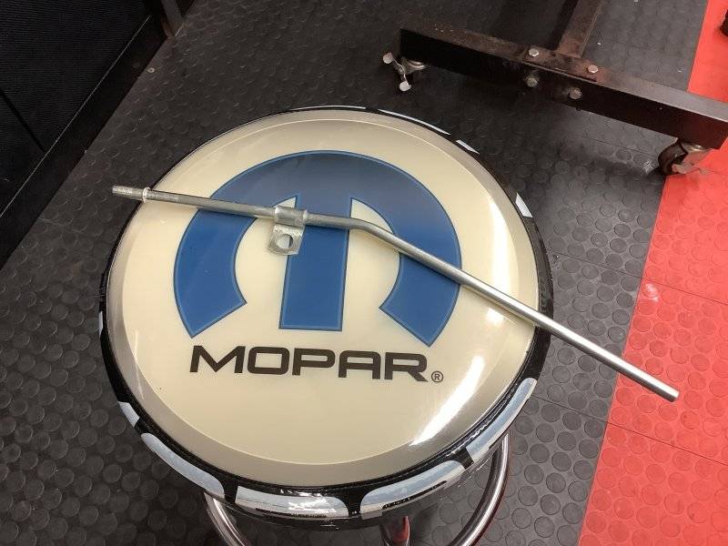

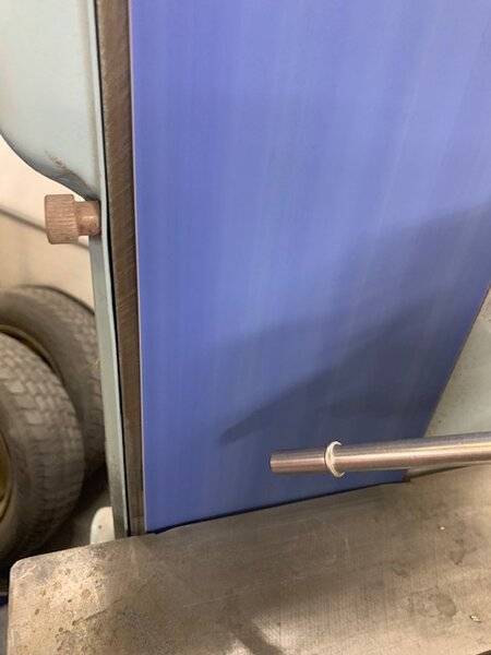

Okay I've seen posts about this in the past & today I got to deal with it... The new reproduction oil dipstick tube is considerably larger O/D than the original... But Original unbroken dipstick tubes are getting hard to find soooo....
First I taper the end that goes into the block, a belt sander is mighty handy for that step...

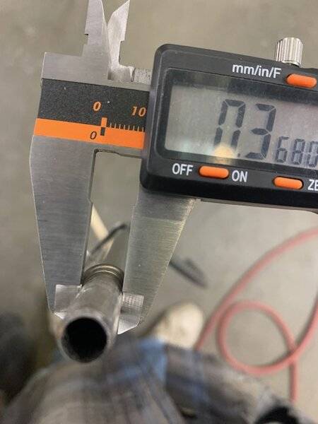

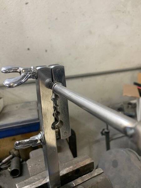

Next I use the clamp from a tube flaring tool to slightly squeeze the diameter of the tube...

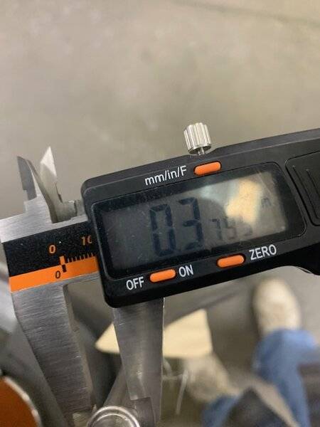

This is the diameter of the tube where I didn't squeeze it..
And here it is after squeezing, .011 smaller...

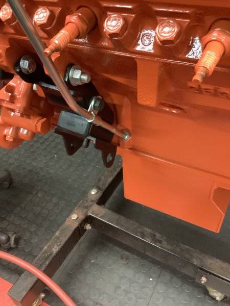

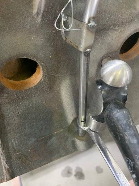

But still a tight fit, I use a 3/8" wrench & a hammer to tap the tube into the block...
Hopefully it helps someone....

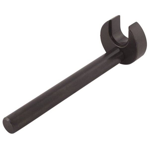

This tool is used for installing GM oil pump pickups, and I think it would be a better way to install the dipstick tube. The installing force is applied in the same plane as the tube, as opposed to perpendicular to it. Note to self, make one...

I've used a 3/8" wrench for 40 years, if you have access, tapping on the wrench directly works fine... If not have one person on the bottom holding the wrench & guiding the end of a long punch so the second person can tap on the punch with a hammer from above... I've installed hundreds of tubes through the years...

Didn't say it wouldn't work (done it myself), just thinking of a better way to do it.

Yup, it probably is better, heck, weld a rod to the head of a 3/8" wrench & your done...

I have put in a hundred with a wrench and hammer just like the previous poster and it works just fine. Your tool does exactly the same thing just from several inches away.
