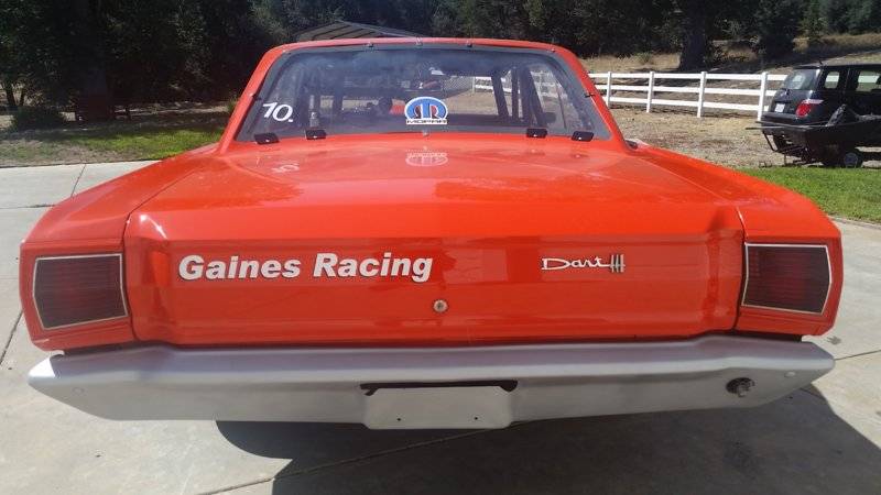

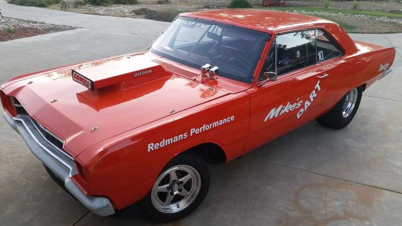

1967 Dart with 1968 Grille. I have a pair of 68 tail lites yet to install.
Mustang II rack & pinion front end, no K-Member or Torsion Bars. C/E 3 way Adjustable Front Shocks. Stroud Transmission Blanket.
Slotted Wilwoods Front / Drums Rear. Line Lock
It is only a 10.40@126mph car but it sure is nice.

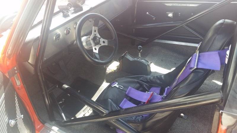

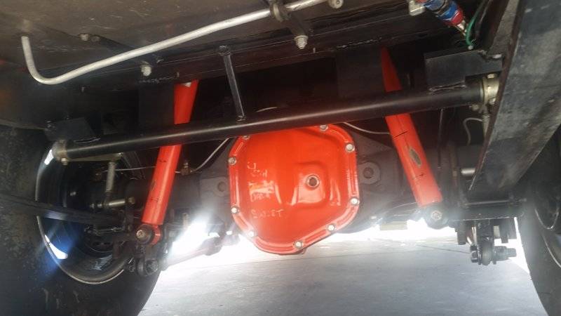

DANA 4.10 with Spool / Pro Trans with Steel Billet Drum, Rollerized Rear Support, Ultimate Sprag and Trans Brake / 4" Driveshaft. B&M Rachet Shifter.
12 point cage / Lexan Front & Rear Windows and 1/4 windows.

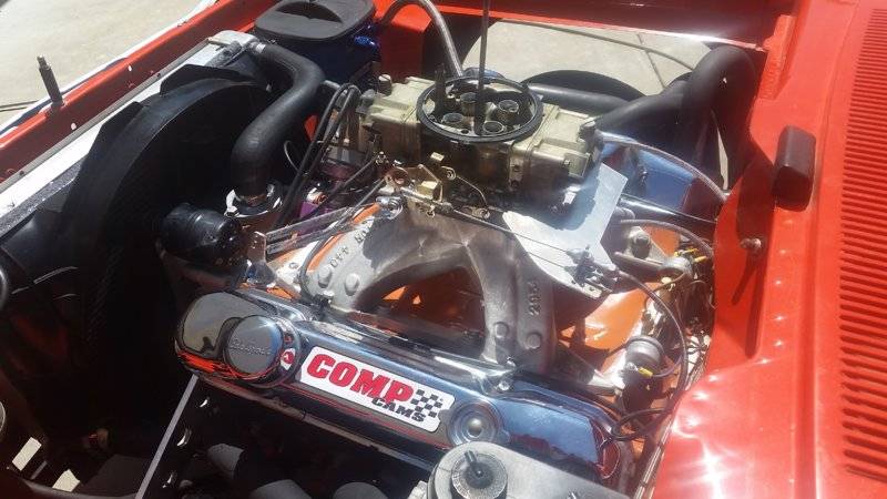

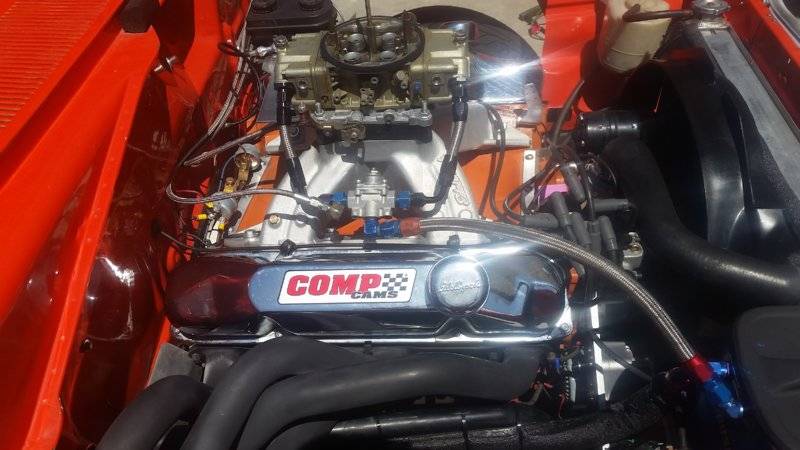

440 .030 over, 446". Mild motor with Ohio Crankshaft Forged Crank, Scat H-Beam Rods, Ross 11-1 Pistons, UltraDyne 5.xx lift cam
251/[email protected], 906 Iron Heads ported to 290cfm
, Smith Bros Pushrods, Crane Rocker Arms. Edelbrock Single Plane w/ 750 Holley, Hooker 2" Fenderwells, Holley Black Pump with 8AN Lines, Chrysler Chrome Box Ignition System. Motor Plate with Alternator attached. PowerMaster Mini-Starter. Old Style Pro Stock Hood Scoop sealed to Carburetor. Belt driven Electric Water Pump and Fan. Jeg's Radiator. Moroso Cool Can.

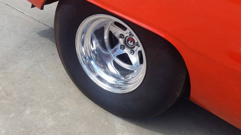

Chris Alston Backhalf. Competition Engineering Link Traction Bars combined with Cal Trac Split Mono-Leaf Springs and KONI Adjustable rear shocks. Billet Specialties 15x12 Rear / 15x3.5 Fronts. 31" RR Tires with 13.5 Tread. M/T SR front tires.

Cool and it has that old style snorkel scoop. Had one on my 68 road runner in 84. And 126 at 10.40? Man, is it hooking hard but at it's limit before the 1000' mark?
