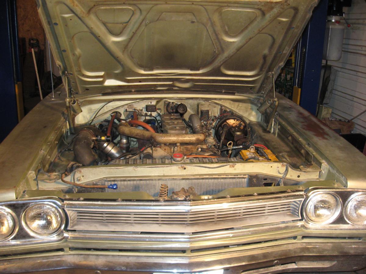

The pics will show you an original paint, rust free,original int. car I scored on E-Bay last June for $2500 from Arizona, with a somewhat out-of-place looking engine. What pics won`t show, I can only say is, it can all be done easily in your shop in 40 to 60 hours .
I`m running it as is `till next winter, then I`ll pull the eng/trans for paint and detailing under hood.
Real smooth down the road, and it doesn`t really care if it`s going uphill or level road.
