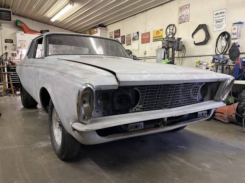

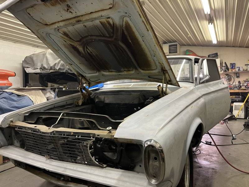

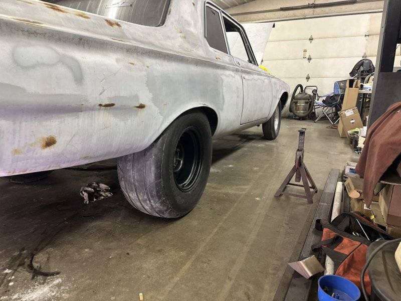

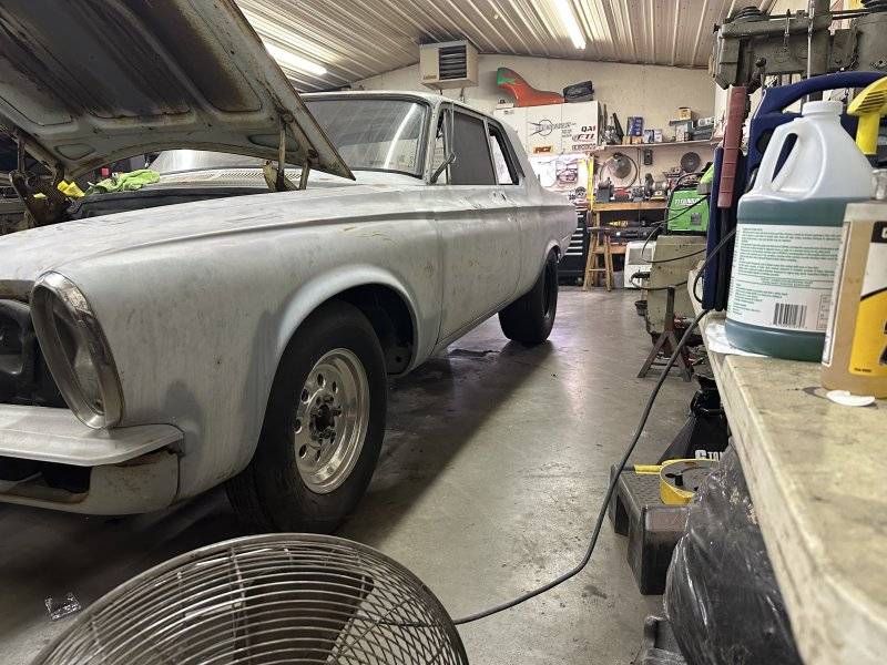

Springs moved inboard, Caltracs. +1 split monos, rear sliders. MT 295/65 r15 on 15x10 5.5” back space.
This will be mini tubbed too, but this will be ‘Street combo’ Getting a mild roots blow 440

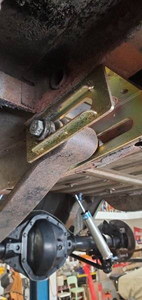

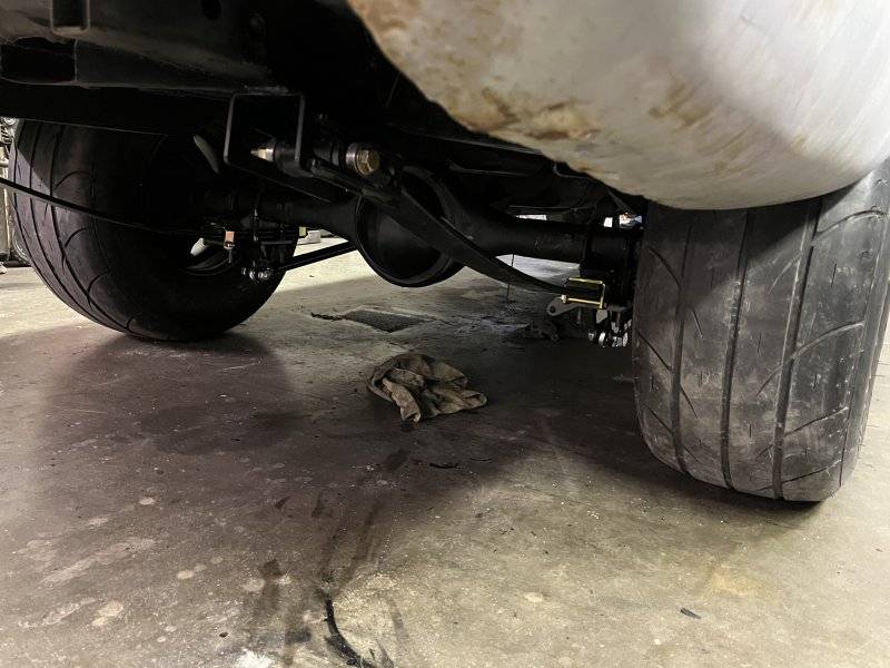

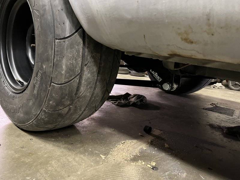

It's not the wheel tub thats the real limit on size. It's the spring. We have a 62 that runs the springs moved flush to the outer rail. Sliders and cal tracs. 10" wheels with 10.5x29.5 M/T Pro Drag radials. Stock wheel wells and tubs except for the outer lip is rolled up. My 64 is tubbed. The frame flange is what limit it. The flange is trimmed flush. Outer lip is thinned to 1/2". 10.5W x 31 M/T's on a 12" rim fit with about 1.2" clearance on each side. Section width is 15.5". This car has ladder bars so no spring interference.
Doug
Looks good. Mine is also mini tubbed with Caltracs and split mono leafs moved inboard but with a -1" ride height. I run either 29.5x10.5W's or 315/60/15 Drag Radials also on 15"x12" wheels..
Bigfoot I would like to asked a couple questions if you don't mind. First one what shocks will you be using. Second on your sliders how much forward travel do you leave before it bottoms out. Thanks for any input bearman

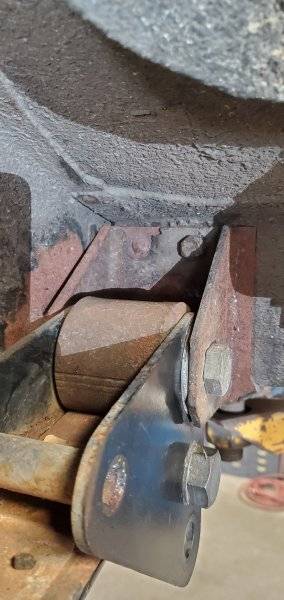

Here's where we ended up. This is with Calvert monos and Cal tracs. Been high 1.3x 60ft with a 3.54
