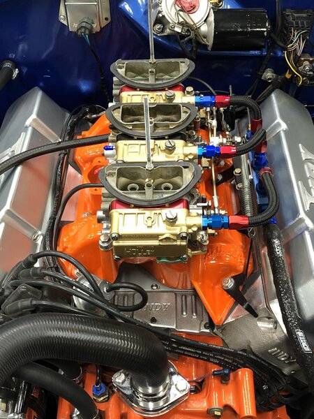

Just putting it out there , have a few that need new homes.
Muscle Motors is out of business. I think they are growing pot and taking care of elderly parents last I herd. No reason to use factory heads these days if you’re not a serious racer in a class that requires them. Plenty of quality stoker kits, the weak link is the block. You are at a crossroads. If you don’t have a known good factory block; you’re either going to get lucky or spend a lot of money.
