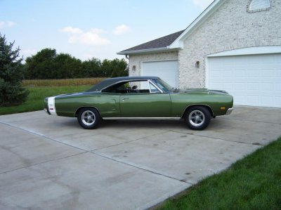

these are 15x7 tt's with a 225-70 t/a radial.

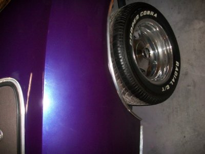

I run 295/50/15's on 10". 4.50 backspace wheels on my 73.
That looks perfect.
The 70 series tirs fill out the wheel wells,and ride height is period correct.
With the same size all around,you can roate the tires to extend the burn-out life of all the tires,LOL!!

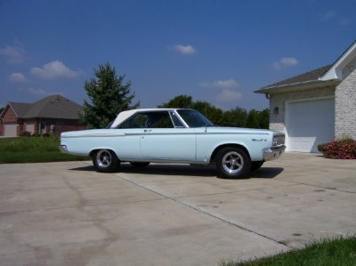

i've done the big tire in back little tire up front on both my cars but have always gone back to the same size all the way around. i just like the way the car handles with the same size tire on all corners. here is a pic of my 65 coronet with 15x7tt's and 235-70x15 t/a radials
