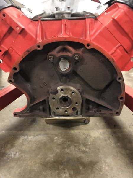

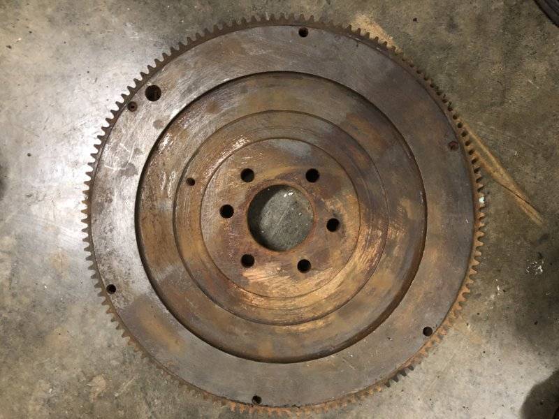

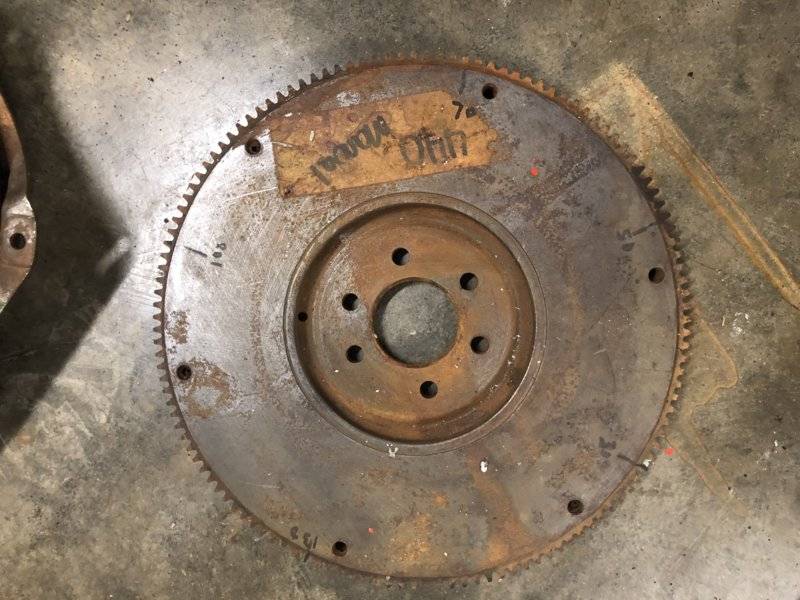

I have 1970 440 built a little. Cans make a external balance flywheel into a neutral at the machine shop? The local machine shop says no problem. Thanks
DFB36B6D-C683-4F18-936F-B6F35B358E41.jpeg 420EB6E8-7A74-4DC7-A4A8-2AA3293B6A2F.jpeg 28ECC4D5-FCD8-4C0D-AE19-85763D09AE5D.jpeg 313DA6D6-0678-44E8-843B-8899A122491C.jpeg
Any good machine shop should be able to zero balance your flywheel.
Yes BUT ... why not spend a couple hundred bucks and buy a safe billet steel flywheel instead of risking things with an ancient cast iron unit. You're going to pay the machine shop anyway, toss that money towards the new one which will come neutral balanced.
That cast iron flywheel is an accident waiting to happen if you miss shifts. Go billet, you will be much happier and your feet will thank you.

The OP asked if a stock flywheel could be zero balanced. Yes they can. Would I do it? For a stock driver that will not be beat on. Yes. For any kind of performance intended usage. NO!
