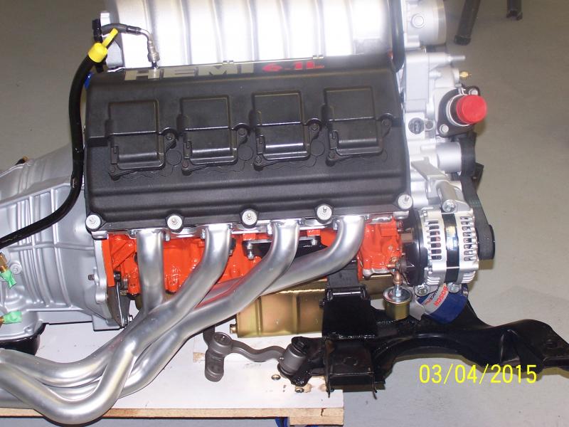

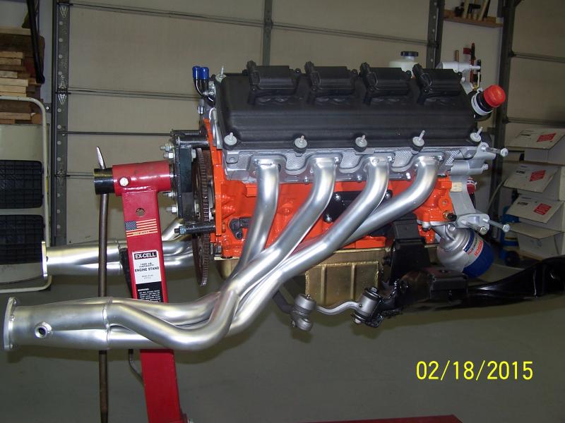

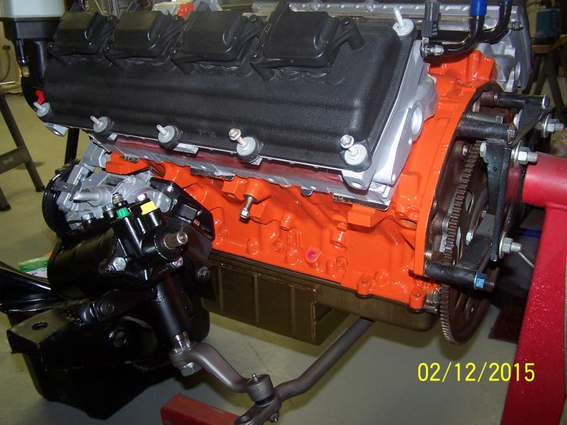

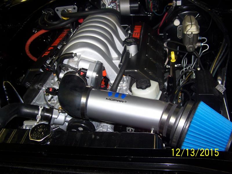

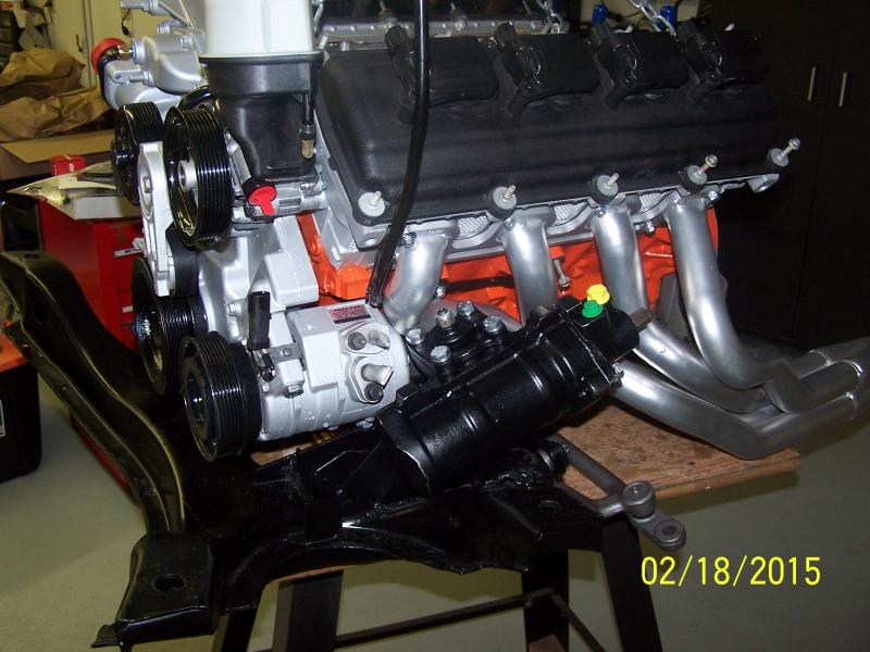

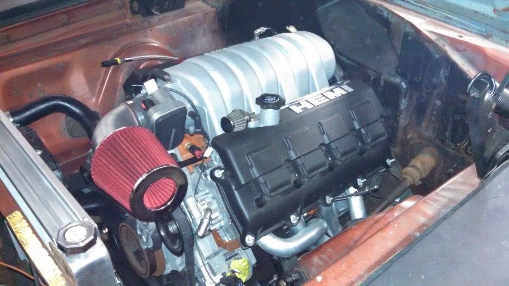

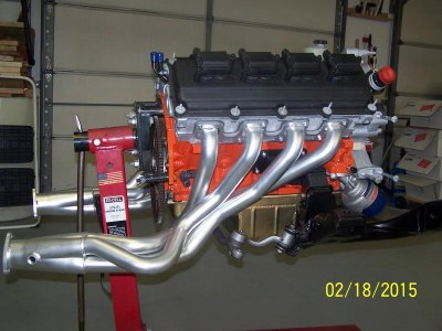

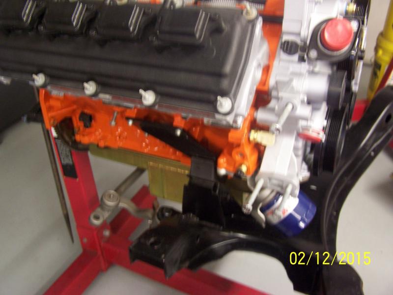

I don't have a thread to my project but it is similar to your plans. I am doing a 6.1 / 545RFE in my 68 Charger. It is mostly complete but not entirely yet. Still have a few issues to iron out. If you go with the 727, it will be a fairly easy swap. Any newer style transmissions will require modifying the tunnel. I needed to raise my tunnel 1 1/2" and widen it about the same. I had to cut the TB hoop out completely and weld in a plate as I am using the factory K frame. My engine is a 6.1 from an 06 Charger SRT8. It came with the NAG1 transmission but everyone said it was a nightmare install to I went with the 5 speed auto from a Hemi 2wd truck. I know there have been negative comments about the 545RFE not able to stand up to the 6.1 but I guess I will have to see for myself as I don't believe it. My brother has the same transmission in his Ram and pulls a 5000 lb trailer in the hills of Montana and has had no trouble as of yet. (over 90 K miles) I don't know what your plans are for your car but mine won't see any road course racing or Wheelie attempts with 14" slicks so I can't imagine my stock 6.1 will eat it up in short order. I expect my car to weigh in about 3800 lbs including my fat *** so still a good 1200 lbs less than the Ram. My car has a 3.23 sure grip 8 3/4" rear with 285/60 rear tires so I am after good mileage and drivability more than tire smoking grunt. If you are staying with the 727 transmission and K frame, at a minimum, you will need an oil pan and pick-up, TTI headers, engine mount adapters, engine management system, and an in-tank fuel pump.

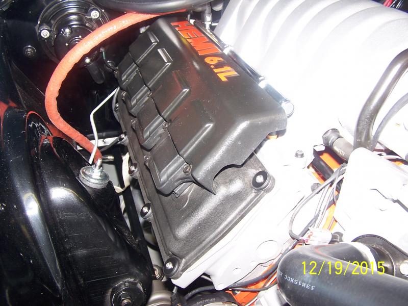

You will also need to deal with the oil filter placement as the stock 6.1 / 6.4 oil filter is in the way.The factory dip stick goes in the pan and will need to be relocated to the other side. You will need a fuel pressure regulator and return line to the tank. I bought a kit from Bouchillon Performance for my install. It was spendy but I didn't want to deal with all the trial & error stuff that goes along with not knowing what I was doing. If I were you, I would give Randy at Bouchillon a call and let him know exactly what you plan and he can get you fixed up. They have the engine management system built to your needs, along with the steel fuel tank that bolts right in place of the factory tank. Here are a couple pics of my install.

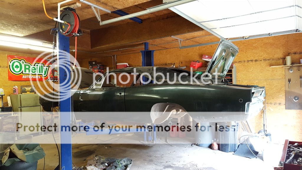

Hello, and welcome to the sight, any pics of this 68' would be appreciated, we love pics..

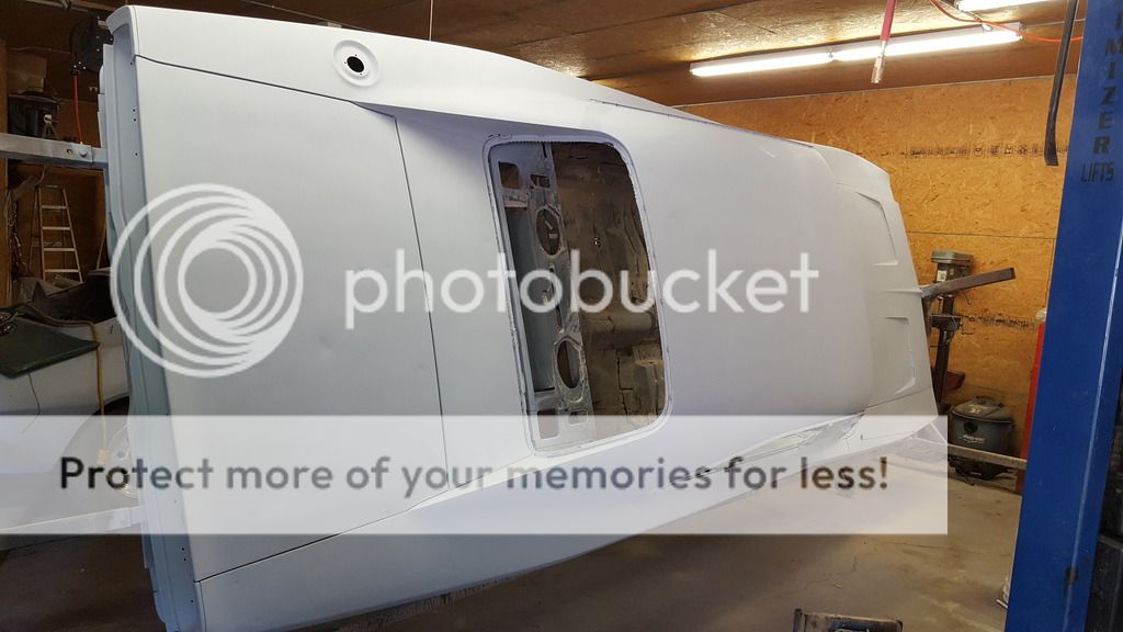

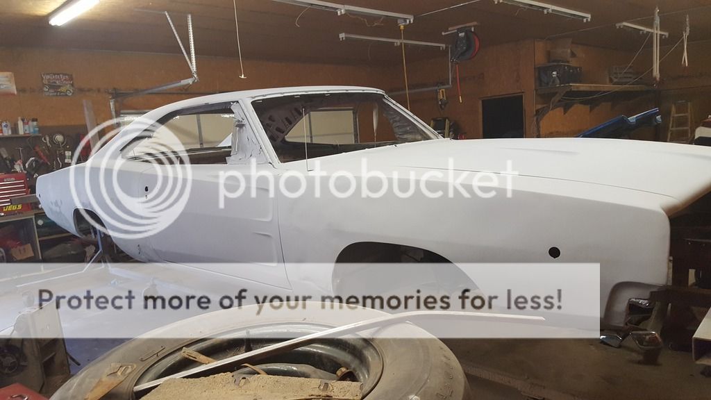

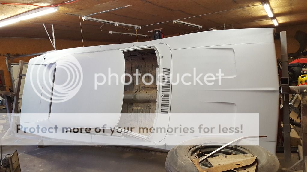

here are some current pictures of the project

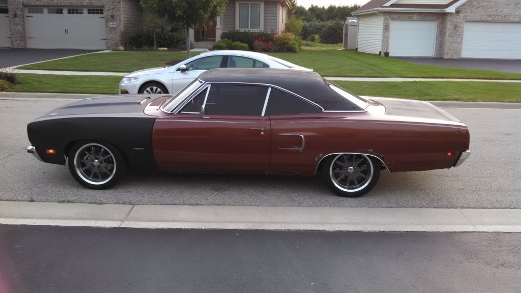

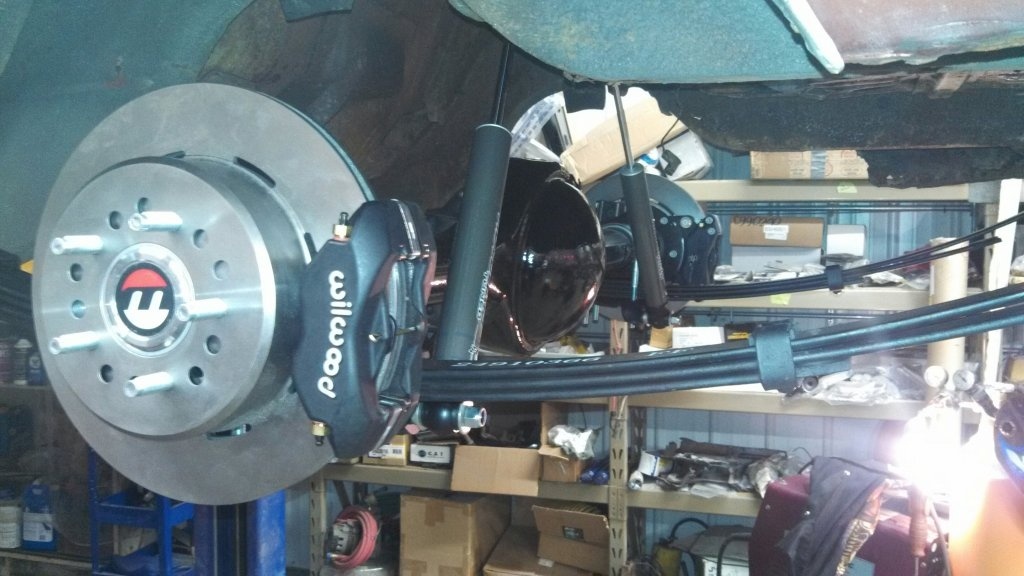

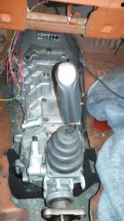

that is gonna be a badass car, good luck with the build, I'm going way into it, i got the ALTERKTION front and rear, and went with the 6 speed with 24 mph on the hi way. body work gets started in oct. if your interested here is my thread... http://www.forbbodiesonly.com/moparforum/threads/my-70-barn-find.36844/

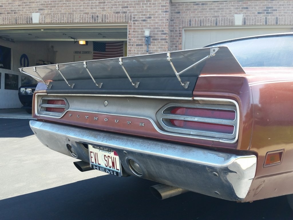

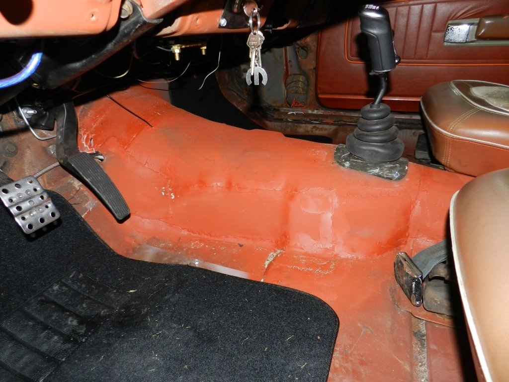

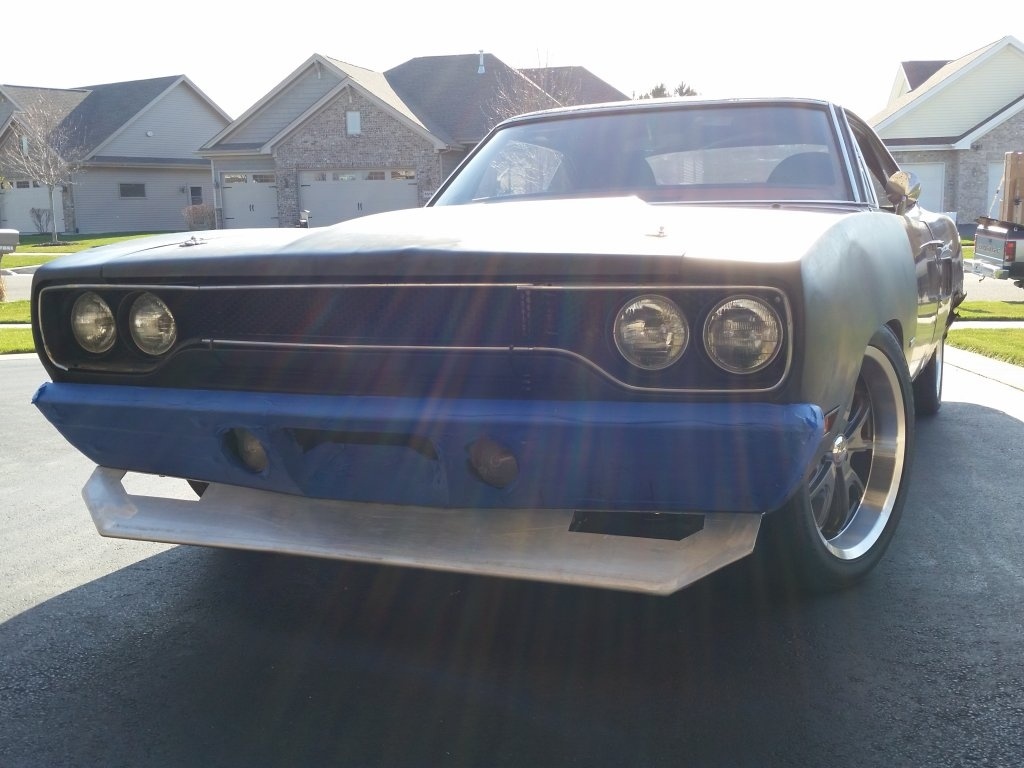

im not putting in a console, I'm going for a race car look, kinda of all my demented ideas, here is a pic how it should turn out, i got the front an rear spoilers all custom made also. interior is not a 100% what we are going to do yet. here is a pic of the hump, he cut the top off an added about 3 inches of metal an welded back in to make look stock.

Thats sick! I wouldn't even paint it! I love it for who it is lol. A nasty abused delinquent chevy embarrassing MOPAR
