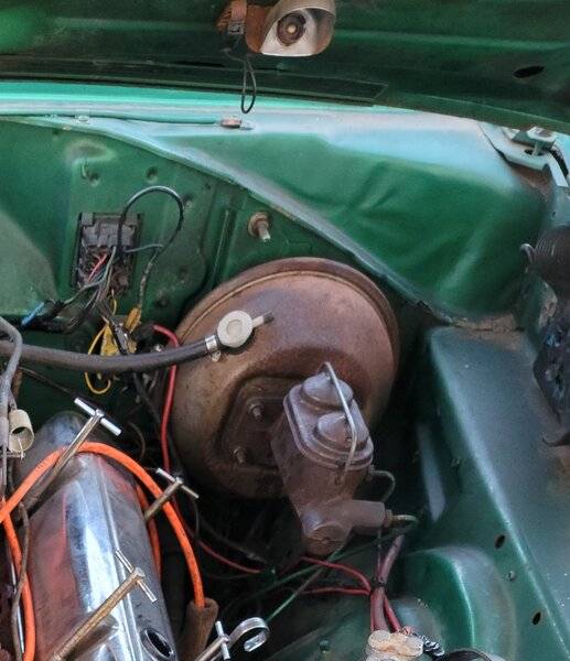

I've got a '68 Plymouth Satellite 2dr.
I replaced front shoes and springs, and I should probably get around to doing the wheel cylinders. Those have not been done yet. I also have not bled the system. Still trying to figure that one out. Never bled a brake system before.
When the car is off, pedal is hard.
When car is running, pedal is soft, all the way to the floor. With basically no stopping power, the brake light on the cluster comes on before I can get stopped. I'm pretty sure I have power brakes, well at least, I'm supposed to.
Where do I start with working through this?
Thanks!!
Well if you didn't have any brake lines off, or knock a wheel cylinder piston out when doing the shoes, you shouldn't need to bleed anything.... I would suggest you didn't adjust the new shoes out to just shy of the drums.

You have power drum brakes front & rear (fyi).
1. Bleed (the air out of) your brake lines. One each brake, there's a little bleeder screw on each wheel cylinder (a little hole in the center of it). Spray those down BIG TIME with PB Blaster rust penetrant. Soak & repeat. Soak again and wait 1-day. Use SIX POINT sockets or box end wrench and "crack open" those bleeder screws about 1/2 turn. Do them one at a time 1.passenger rear 2. driver rear 3. passenger front 4. driver front. One brake at a time, have a buddy push down slowly on the brake pedal while you "crack open" a bleeder screw. As he pushes the pedal closer to the floor, you close off that bleeder screw. He lets the brake pedal move back up & repeat. You're basically trying to "burp air bubbles" out of the brake lines. Each time, make SURE you close off the bleeder screw before your buddy releases the brake pedal or you'll suck air back into the brake line....just "burp" it out again if this happens. All the while, keep topping off the brake fluid in the master cylinder reservoir (slide that metal wire clamp thing to one side by prying with a screw driver and it will open up).
2. After you've bled each of the brake lines, in order, and until you got a good flow of brake fluid out (& no air bubbles) whenever your buddy pushed down on the brake pedal.....then test the brakes with the engine running.
3. If the brake pedal still goes to the floor, then look for leaking brake fluid anywhere along the brake lines going to any of the brakes. You can also inspect the wheel cylinders (or near them) for signs of leaking brake fluid. If you find a leak, fix it and bleed the brakes again.
4. If no leak is found, the brakes have all been bled and there aren't any leaks.....then for sure, your master clylinder is bad.
Let us know. We can all talk you through replacing a master cylinder if needed.

Hey PurpleBeeper,
So, I followed your instructions and the only wheel that had brake fluid flow out was the passenger front wheel. The other 3 had no fluid that came out. I'm thinking probably collapsed rubber lines or blockage in the metal lines? At this point, I'm thinking I should replace the wheel cylinders, rubber tubes, fittings, etc., and then bleed again?
I did attempt to bleed with the lid of master cylinder off, and the fluid did shoot out of the front reservoir whenever I let off the brake. Saw negligible, if any, movement on the rear reservoir. Removed the fittings from the master cylinder and when the brake is pressed, fluid does come out of both openings, but it does shoot quite aggressively out of the front reservoir anytime the brake is pressed.
Let me know if there is anything else I can provide to help troubleshooting.
