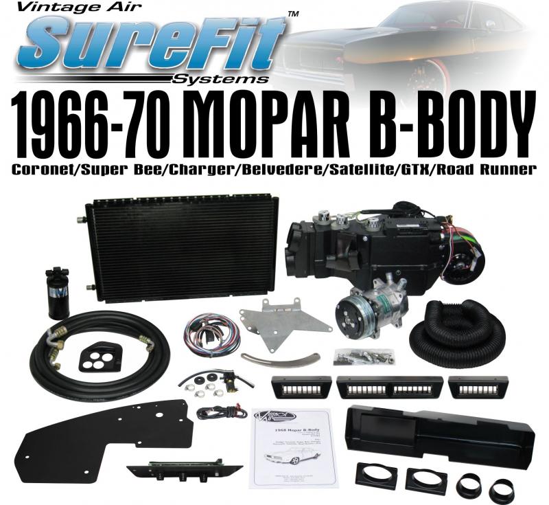

I E-mailed Vintage air a few months back about a kit for my '69 Coronet non-A/C car and they said to check back in a few months, so I checked today and they now have them on their website! The '68-70 kit comes with a new electronic control panel, the '66-67 had electronic adaptors for the stock cables. They have kits for cars with factory A/C that use the stock vents, ot a kit for non-A/C cat that has new under dash vents.
I just placed my order.
http://www.vintageair.com/6670moparbbody.asp

The A/C Kit arrived today, so I started taking inventory and there are a few pieces missing.
I'll call when they open an see how their customer service is?
Missing were the drier, and the four hardlines that go through the inner fender.
I ordered the kit through Summit Racing because I was getting a few extra parts at the same time, and I think there was some confusion going through them.
Next time I think it would be easier to contact Vintage Air direct.
The Condenser looks nice, I think it is 16"x28" and bolts to the factory holes in the radiator support.
The Compressor brackets look nice, I think laser cut? I won't be using them or the compressor in the kit because I have the Billet Specialities Tru-Track kit with A/C.
The Gen IV Evaporator looks pretty compact and smaller than I thought it would be.
The under dash vent housing is fairly thin plastic, same with the glove box insert.
The control panel looks ok, painted flat black.
I'm not sure why they have the large firewall plate, other than to cover the factory heater and A/C holes? Does the fan come through the firewall on factory A/C cars?
For a car without factory air, you just have the two heater hose holes to plug. The plate does also act as a template for drilling the holes for the Evap support bracket inside the car. Bolts in with two 1/4" bolts to the firewall, and two large screws inside to the cowl that holds the front evap bracket.
