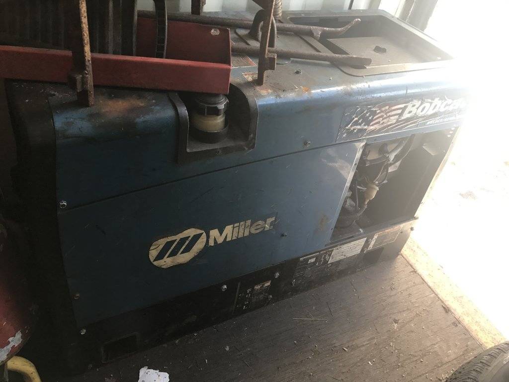

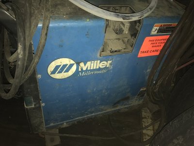

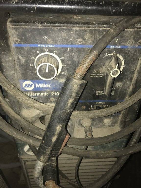

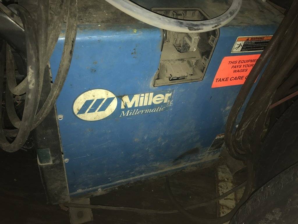

picked up a couple welders that supposedly did not work, one is a miller 250 bobcat arc welder with an 11000w generator, checked fuel filter, dumped fuel in it, added oil, put a battery in and it fired right up and ran flawlessly. Second is a miller millermatic 210 mig, replaced ground clamp, new wire spool, cleaned the voltage regulator contacts reset the rollers and feeder for proper wire alignment and it works perfect. Also got an ingersoll rand gas compressor I'm not sure what if anything is wrong with that and 2 14" chop saws.

Great score. Bob Cat is a decent stick machine for general fabrication/ maintenance use. Because there air cooled they do work harder when welding with higher amps. Change that oil and filter before you use it a lot, very important in a air cooled machine.
