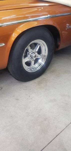

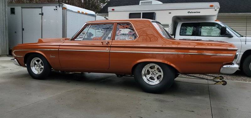

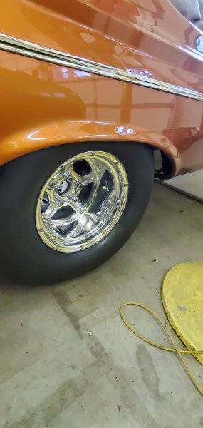

Got the new Billet Specialities wheels on. Went up to 12" from 10". Need a little fenderwell trim. There a little close on inside and outside. Nothing a little grindind wont take care ofRears are 10 lbs lighter each. Fronts are 5 lbs lighter each..

I broke the 10" rears. Thats why the new wheels. The 15x4 fronts are going on my sons 62 savoy.

Man that car's stance makes a statement. Pretty intense. I love it.

If 10” broke wouldn’t 12” be weaker?
With that kind of power might want to think about drag wheels not street wheels (just my thoughts).
Thats why I purcased Billet Specialties. They are billet center, SFI rated. It's funny. They ran the American 200S in both Trans-Am and in Top Fuel back in the day. They may have survived if i had rounded the inside edge of the spokes. But I can't take chance. Car is too nice and to quick (8.98@150). Even contacted American about the repop 200s. They asked how quick the car was. And said no ah ah. It's been 1.24 60ft off the foot brake.
