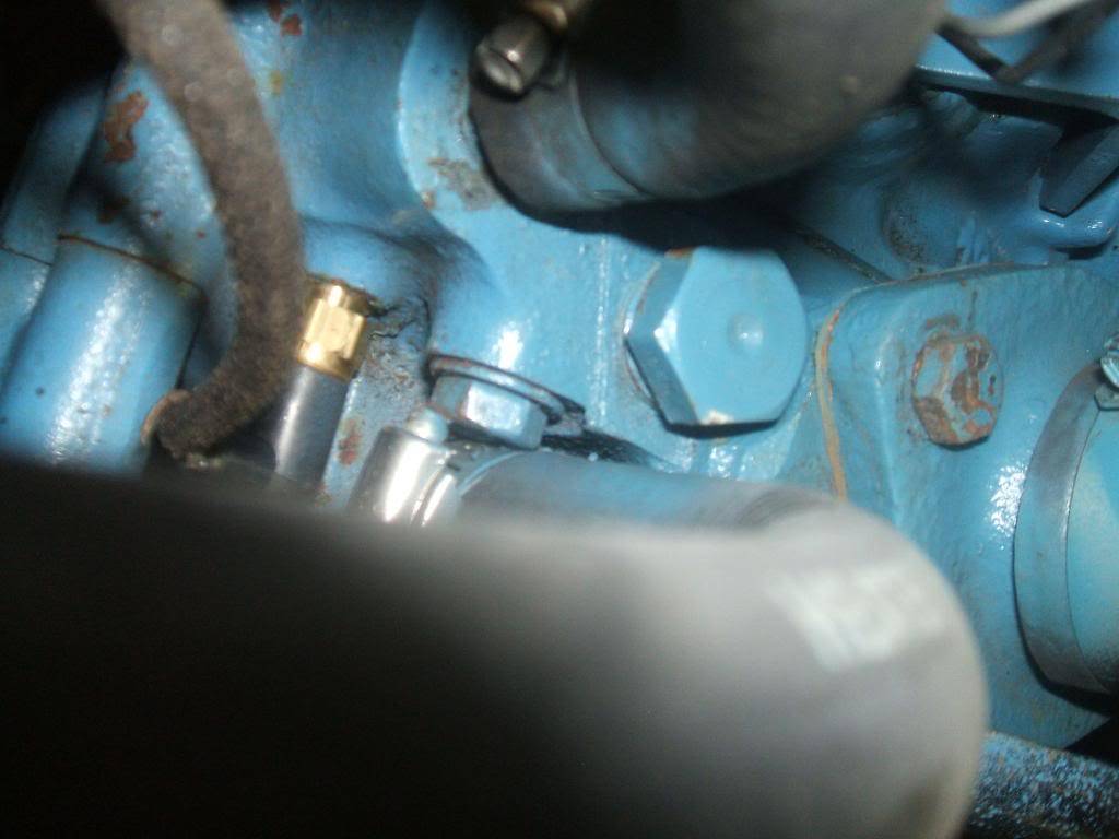

Have purchased a 70 RR (383 car) recently. Has the rally dash/gauges.
Going to install a 3 gauge panel from Autometer (full sweep oil pressure, temp & volt) but want to keep the rally gauges working is possible.
Looks like there are locations next to both the senders for oil pressure and temp but thought I would post photos of them to make sure that installing senders for the auto meter gauges will work in those two locations....
thanks
Oil pressure location...just to the left side of the oil pressure sending unit... the small plug
Temp pressure location...that large bolt/plug head facing up to the right of the temp sender
Yep, those are popular locations that work well.
