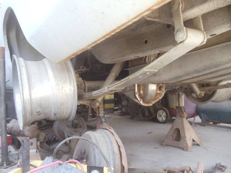

A couple of questions. I know 3/4 and 1 ton pickups/vans usually have "full-floating" differentials (a difference in axle bearings of some kind compared to the average passenger vehicle differential). Photo is a local '69 Charger with a transplanted Dana 60 from a truck. So I would like to ask:
Does the Dana 60 have the "full-floating" type axle bearings?
What is the next step "up" from the Dana 60 (stronger, heavier)?
Thank you.

If it was transplanted from a truck it would have 8 stud wheels. Unless it was cut and car bearing hubs welded in. There are some odd dana 60 5 lug truck axles but they would also have a larger bolt circle as the car has the 5 on 4.5 pattern. What makes you say it was from a truck? Also from a truck it would not have a pinion snubber provision. Does the one in the picture have the pinion snubber or provision?

I have a cut down 1 ton truck Dana 60 under my Challenger. We cut off the full floating housing ends, narrowed and welded on Dana car housing ends from Strange along with a Stange 4:10 Pro Gear, light weight spool, 40 spline gun drilled axles and 5/8" Studs. The truck housings are a thicker diameter tube also.
Because that's what the Mexican owner/mechanic (a local "Mr. Mopar" who owns a 'Cuda, Road Runner, Charger, Satellite Sebring Plus, and Belvedere) told me (vehicle is located in Mexico).

I also used a similarly modified truck Dana 60 in my Cuda. There was no provision for a pinion snubber.
