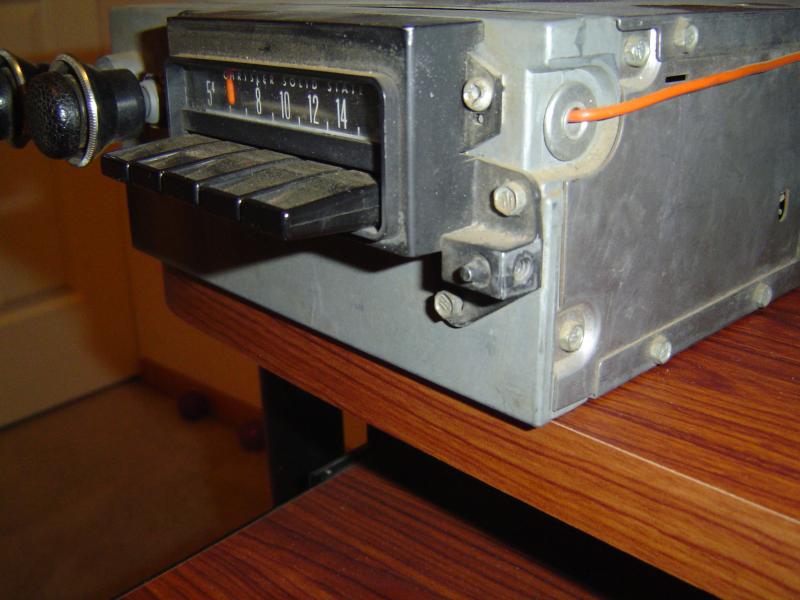

If its like 73 then remove the entire radio before removing the cluster. There is a hidden bolt on the right side front of the radio, you have to remove your ash tray assembly to get at it.
Thank you
I figured it out though, but my am-fm is similar. That little bolt hole about 1.5" to the right of the right most station button, on the side was it. Only accessible through a hole in the ash tray opening. I also removed one of the ventilation ducts which was kind of in the way too.

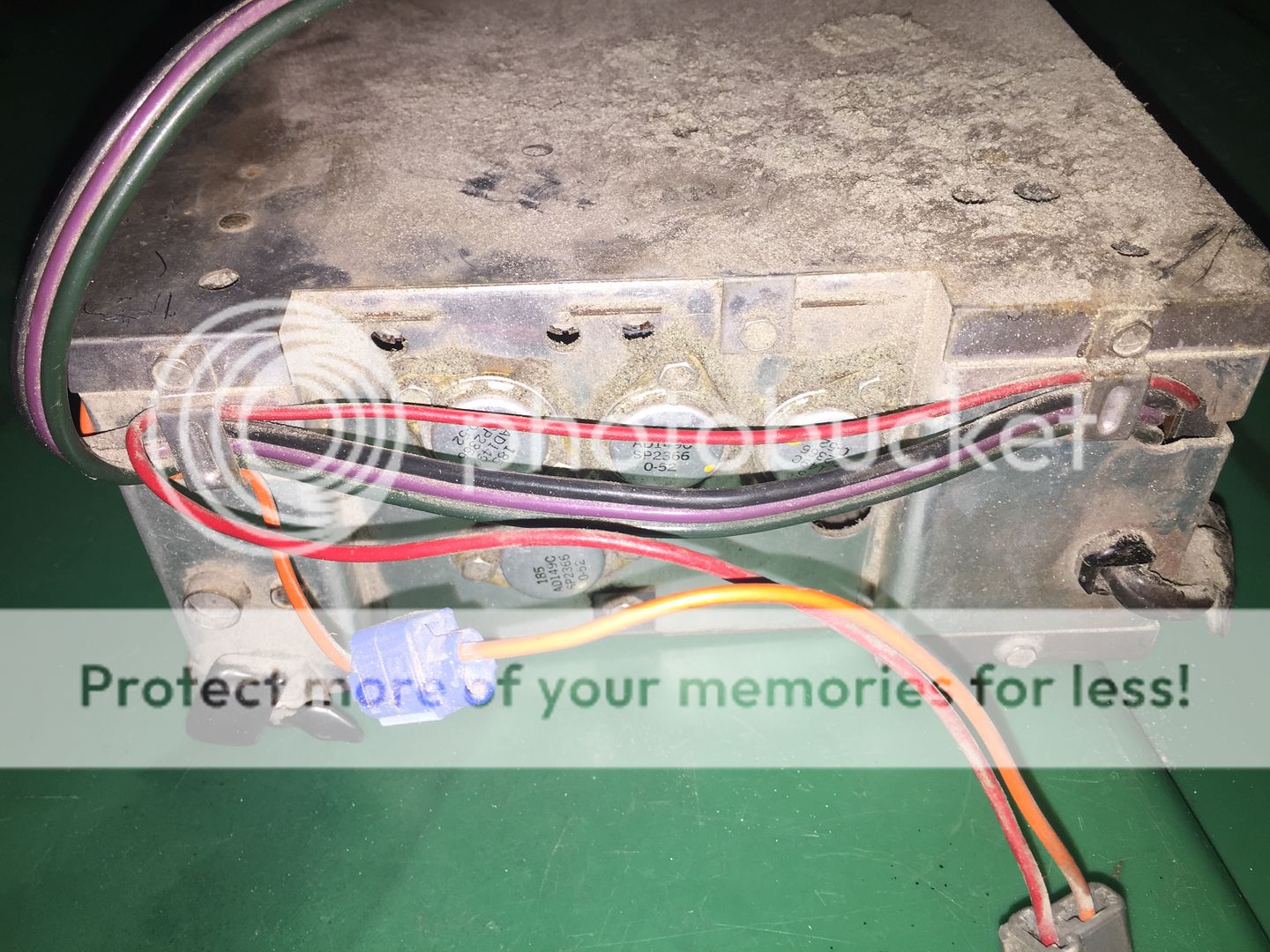

One note of warning though. When I pulled my radio, I found my turn signals no longer worked! I spent weeks troubleshooting this and got nowhere. Then I read on another forum that power for the turn signals is routed through the radio and I had to cut and splice the two power wires going to the radio to get my signals working again. I've been told time and again by some folks on this forum that this is not the case, but I know what I did and what I had to do to get the signals working again, and I'm not the only one who's had this problem.

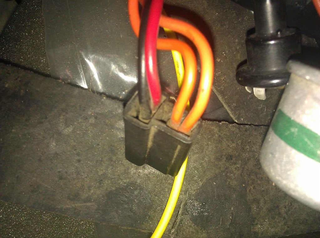

In the interest of only accurate information being posted here, the power to the turn signals does not run through the radio. Simply disconnecting the original radio connector form an intact dash harness will not cause the turn signals not to function. As stated before, the turn signal power source runs through the radio power connector in the dash harness, not the radio. If this connector is cut off, or disturbed in some way, the two wires (black & red with white trace) that were crimped together in one female Packard connector originally, will need to be re-connected together again to restore turn signal function. Referring to any of the wiring diagrams will verify this as FACT.
So, the connector you can see at the bottom of my picture above, which only has the one orange and one red wire, should connect to a 4 wire receptor, and the signal connection turns back within the connection.
