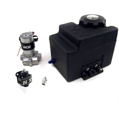

) I don't think you need a dedicated fuel system below maybe 150hp or so. Just run good 93 octane gas & a good, high flow fuel pump (Holley blue or better)
I appreciate the advice, but since I'm running a Carter M6903 mech fuel pump, if I start "adding on" to the fuel system, I may as well go with the S.A.F.E. Tank-I REALLY like the concept and being able to put some high octane race fuel or even locally available AVGas in it.

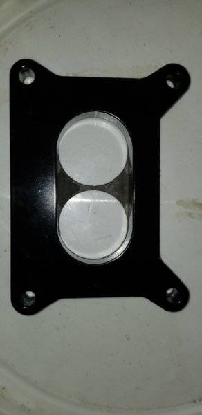

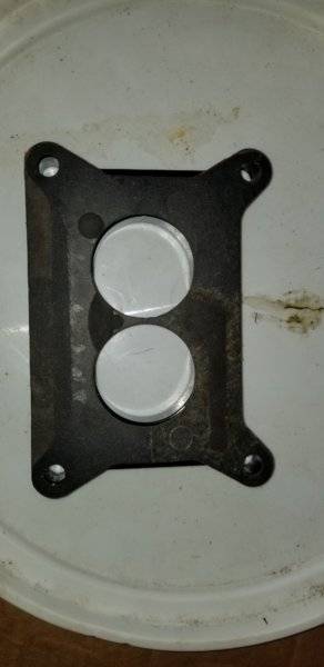

I received a plate for the 3 x 2 bbl NX nitrous system today! It was supposed to be the center carb spray plate, that is what the packing slip says, but it is just a spacer like the kit comes with for the outboard carbs. :(
The good news is it does look like it matches up to everything, so Monday I will let NX know about the error, and likely go ahead and get the system.
Here's an old gasket from my 6 bbl and the plate that NX sent me.
