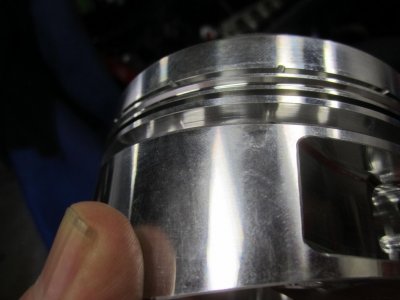

With boost or squeeze,the ring pack must be lowered in the piston.
