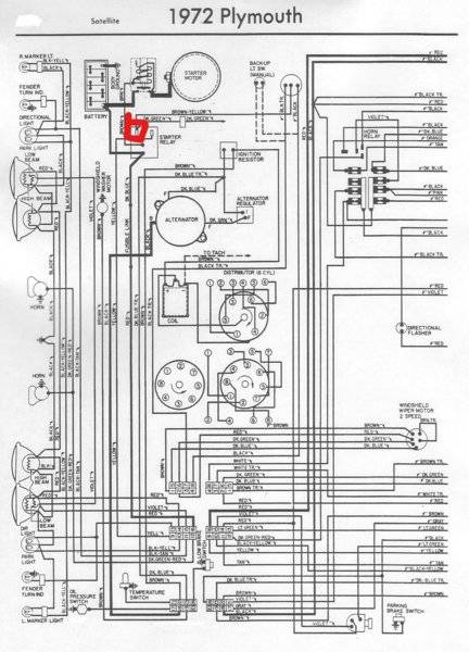

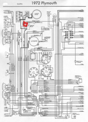

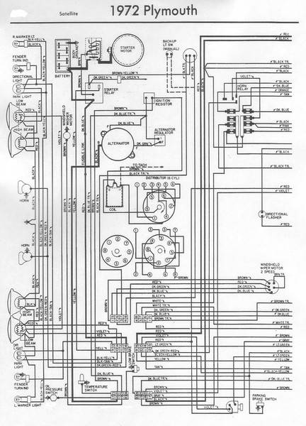

did you try a different relay that could be you problem? The neutral safety switch wire should be a brown and yellow wire, solid yellow color wire goes to the key. Did you do what I said in post #7? Note the position of the yellow and brown-yellow wires in the diagram for the location of the wires. The neutral wire location is the one in the red area. Click on the pictures to make them bigger.
View attachment 586373 View attachment 586381
