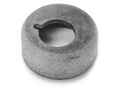

The eccentric is ground into the camshaft, it is on a big block anyways. The part that wears out is the rod between the cam and fuel pump lever.
Try your local auto parts store for esentric. Also there is no push rod for small block fuel pumps. Just a pump arm and esentric. Have you changed the fuel filter because if it is plugged after a set pressure the fuel pump bypasses fuel and there is no suction. You can do a fuel flow test but if you have the equipment or access to it a pressure test would be better should be some where between 3 and 7 psi
Thanks all, I try and rent a fuel pressure tester tonight. It's my understanding that small blocks have the essentric not a rod like some big blocks. Local parts store don't carry so I will start looking online. I will let you guys know how things workout tonight
IIRC, (been a while since working on a sb) the eccentric has a small slot that indexes the camshaft keyway. If the cam bolt is loose, the eccentric could be freewheeling and the cam sprocket wobbling, producing your erratic timing. Just a WAG on my part.
Just finished taking off the front accessories and the essentric. The timing marks were off by about 20 degrees and the chain plenty of slack. The essentric wasn't lose or anything and it didn't seam worn. Replacing all parts to be sure and going from there. I'm sure an electric pump would be easier but you just gave to know sometimes.
