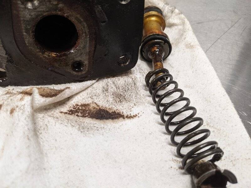

The game plan today was to flush the brake system (the new 69 Road Runner) with new fluid. We bled the front ones and started in with the rears, but no pressure. At that time, we noticed fluid seepage coming into the passenger compartment and fortunately, I had a couple of remanufactured OEM master cylinders in stock. Got the new one installed and bled the master cylinder on the car, but still no rear brake pressure (I have no idea whether this problem existed prior to today). This now leads me to believe that the problem is in the proportion valve block.

As you know, this car has been sitting for quite some time & the original master cylinder had a ton of crud come out when I pulled the valve out of the bore. I cracked the rear line coming out of the block, applied brake pressure nd nothing, just a couple of drips. If it is the shuttle valve, is there anything that can be done to free it up?

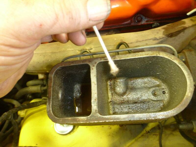

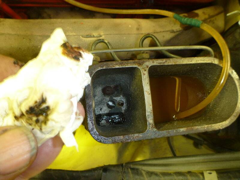

Hind sight is 20/20 Mark... but next time before you start to do this. Drain the master, wipe it clean and then fill with fresh fluid. Probably where the trash came from in the master plunger..

I'll clean it up & put it back in. Got to keep that originality with patina! I'll take that Raybestos part number when you get a chance.
Thinking about it now, I think I'm going to order up 4 wheel cylinder kits & take one apart tomorrow. If the master cylinder looks that bad, the wheel cylinders can't be that good either.
