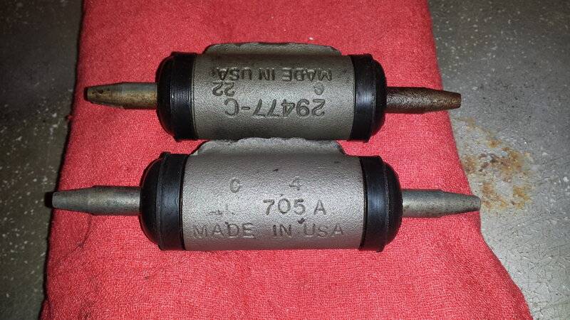

Thinking about it now, I think I'm going to order up 4 wheel cylinder kits & take one apart tomorrow. If the master cylinder looks that bad, the wheel cylinders can't be that good either.
There goes an originality point.
Rock Auto usually has that stuff dirt cheap.
Good Plan.... Original is neat, but if your gonna drive it safety is more important... I've known of a few original cars that got wrecked because the brakes failed...
Wheel cylinders honed, rebuild kits inside and all is still OE. Same with the master HE's PUTTING BACK on! lol
We never even pulled wheel cylinders off a car to hone them for rebuild kits when I was a teen. No reason to..
Hate the end covers on those wheel cylinders. Imagine they seal better than the ones slip on into a groove. Curious to see the insides of wheel cylinders.
The older type are stiff as all get out. The new ones are floppy junk. I rebuilt my cylinders and kept the originals as they were in nice condition. I even got older, made in the USA rebuild kits when I ordered through Rockauto.
Use to be you could buy just the cups, no end cover, no spring expander... Shop I worked at had those cardboard parts pins with cups from 5/8-1 1/4..

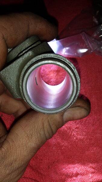

I cleaned up the master a bit and there's some good pitting in the bottom of the cylinder. Looks like it'll have to be sleeved.
Id follow MoparLeo"s advise post #11. I rebuilt a lot of wheel cylinders and calipers back in the day but on cars were I was unsure of how old the cylinder was, how many times it had been honed, I would replace it and remember back then aftermarket meant still meant made in USA.
That entire braking system needs to be gone over as its contaminated. Id replace all the brake hoses and lines, clean and check the distribution block and don't forget the block on the rear that feeds each wheel. Originality is understandable but safe brake system that will stop a car in a emergency situation is a little more important
Bet wheel cylinders are rough do'em all and be done with it. Your probably thinking the same.
There is a place online that sleeves them in brass or stainless. I can't remember at the moment but was going to have mine done before I went to front discs.
